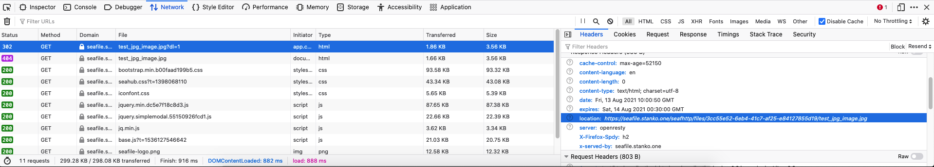

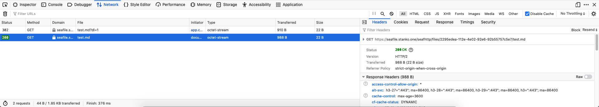

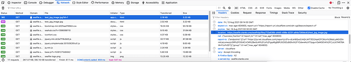

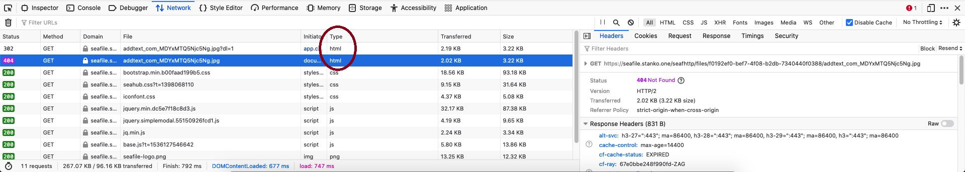

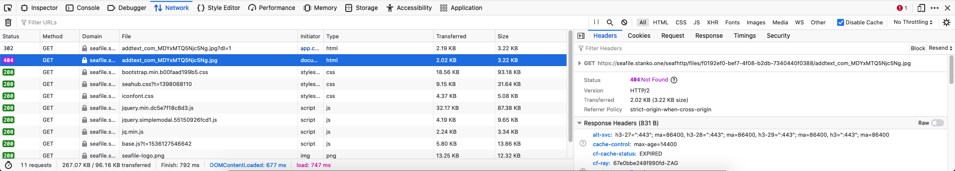

Thanks for the response. I’ve checked and see nothing unusual. Here are the screenshots, first one is 404 for the jpg and the second one is getting the md file which is working. Maybe you can spot something?

I’d say this is odd:
That should be jpg.
Check the location in the response header of the 302 response.

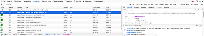

Here it is:
I think you are onto something, any idea what exactly might be wrong?

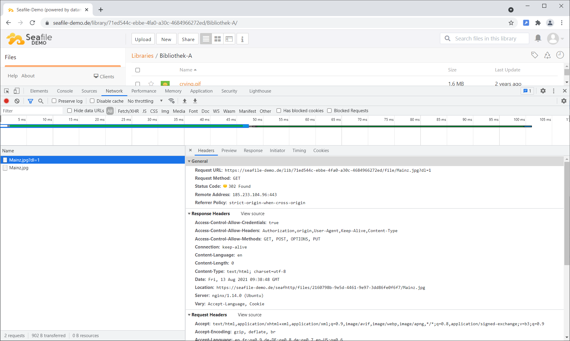

This is the output on my test system:
I’d say your problems are a thing of the past when disabling cloudflare - the use of which is really something you should mention in your problem description.
