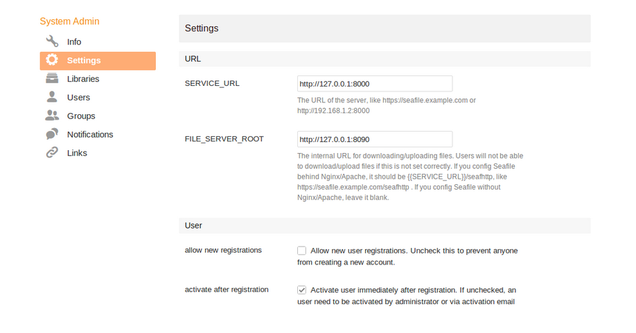

It seems that the ā€œURLā€ topic is gone from the admin webui (SERVICE_URL).
I can only set those through environment variables.
Is that by design?
It is by design. It is documented in the upgrade notes (Upgrade notes for 12.0.x - Seafile Admin Manual)
Dammit I tried to find the documentation, sorry.
You better update this screenshot:
under ā€œServer Configuration and Customizationā€ on v.12
Thanks for the notification. We will upgrade it soon.
