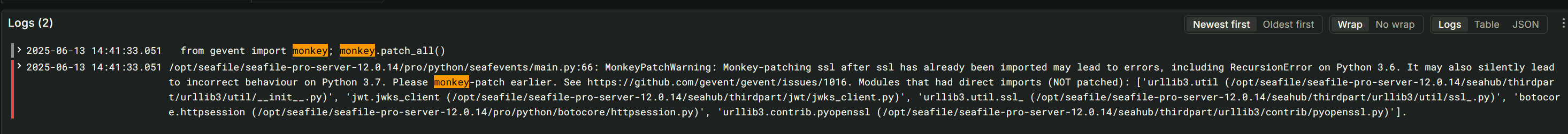

It looks like Seafile is using gevent, so it needs to do monkey-patching (https://%%stackoverflow.%%com/questions/49820173/recursionerror-maximum-recursion-depth-exceeded-from-ssl-py-supersslcontex. But my logs indicate that this is not happening at the right time:
Any hints on how to address this are appreciated.
