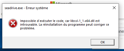

Hello,
When starting automaticly Seafile (7.04 or 7.07) and Seadrive at logon :
then :
But no problem to start Seadrive “manually” after this errors.
