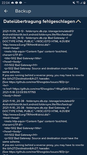

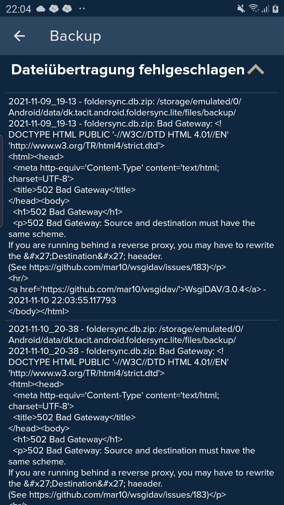

Hello
I runnig on 8.0.7 an still have same issue only with FolderSync
Keepass should work well
If “use temp file schena” disable foldersync is working.
But is there a other solution? With apache2

Same issue in FolderSync App
Have also issue with rename folder.
On windows, linux and android webdav client
Update.
I switch from Apache2 to Nginx should work now no issue
