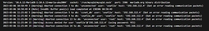

ERROR on Seafile container after colume path change:
Failed to connect to mysql server using user “seafile” and password “***”: Access denied for user ‘seafile’@‘192.168.112.4’ (using password: YES)

MYSQL Contrainer error
