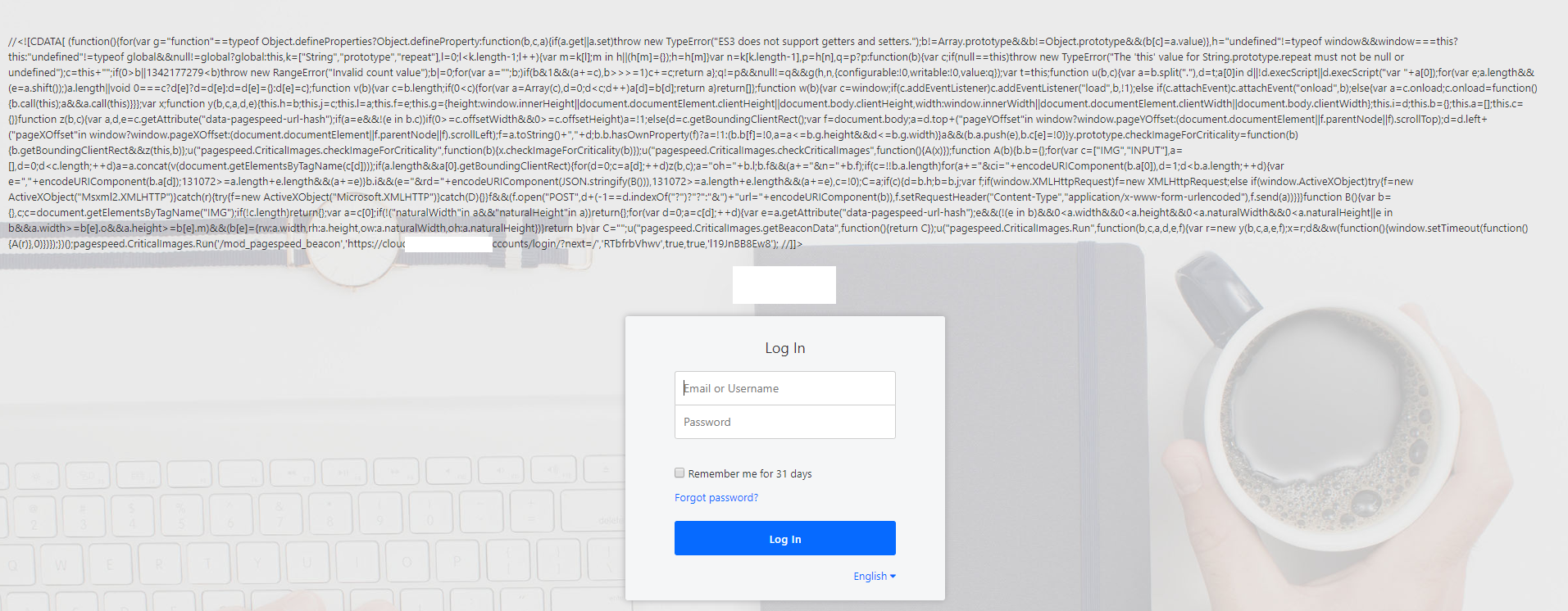

Undesired behaviour when viewing login page after visiting share link, Seafile CE 7.1.2:
Reproduce: Share something via external share link. Visit that link in a browser session where noone is logged in, click logo on top left to go to base url / login page. result:
Reproduced in latest chrome and firefox. Force reload of the page (Shift+F5 in chrome) fixes the issue once
Hello, we tested this issue locally but everything goes fine.
Have you checked seahub.log, any error messages ?
Hi @lian
I tried to reproduce it to check the logs, but the issue seems to be gone. Maybe it was a glitch on our installation, I’ll keep an eye on it. The issue above also seems to be gone
