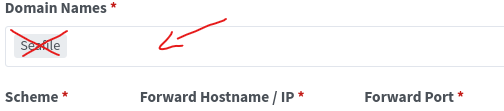

!Important!
The Domain Names section must contain the domain you want to use to access Seafile.
You have only entered the name of the service there.
This prevents Nginx Proxy Manager from forwarding the address to your destination.
