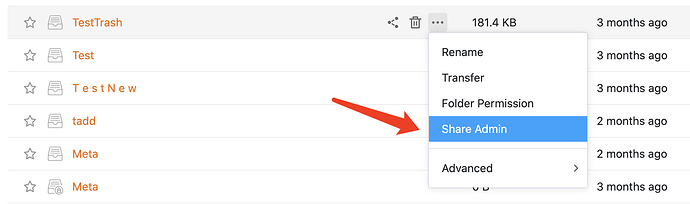

Could you please verify the “Share admin” settings of the library to ensure you have access to all folder shares?

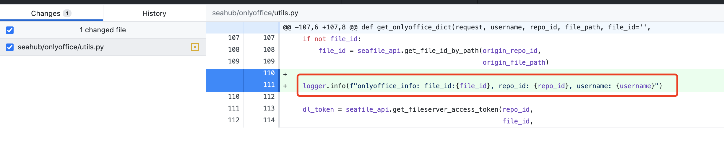

Additionally, adding some debug code would help confirm that the parameters hold correct values, like the example shown in the screenshot below:

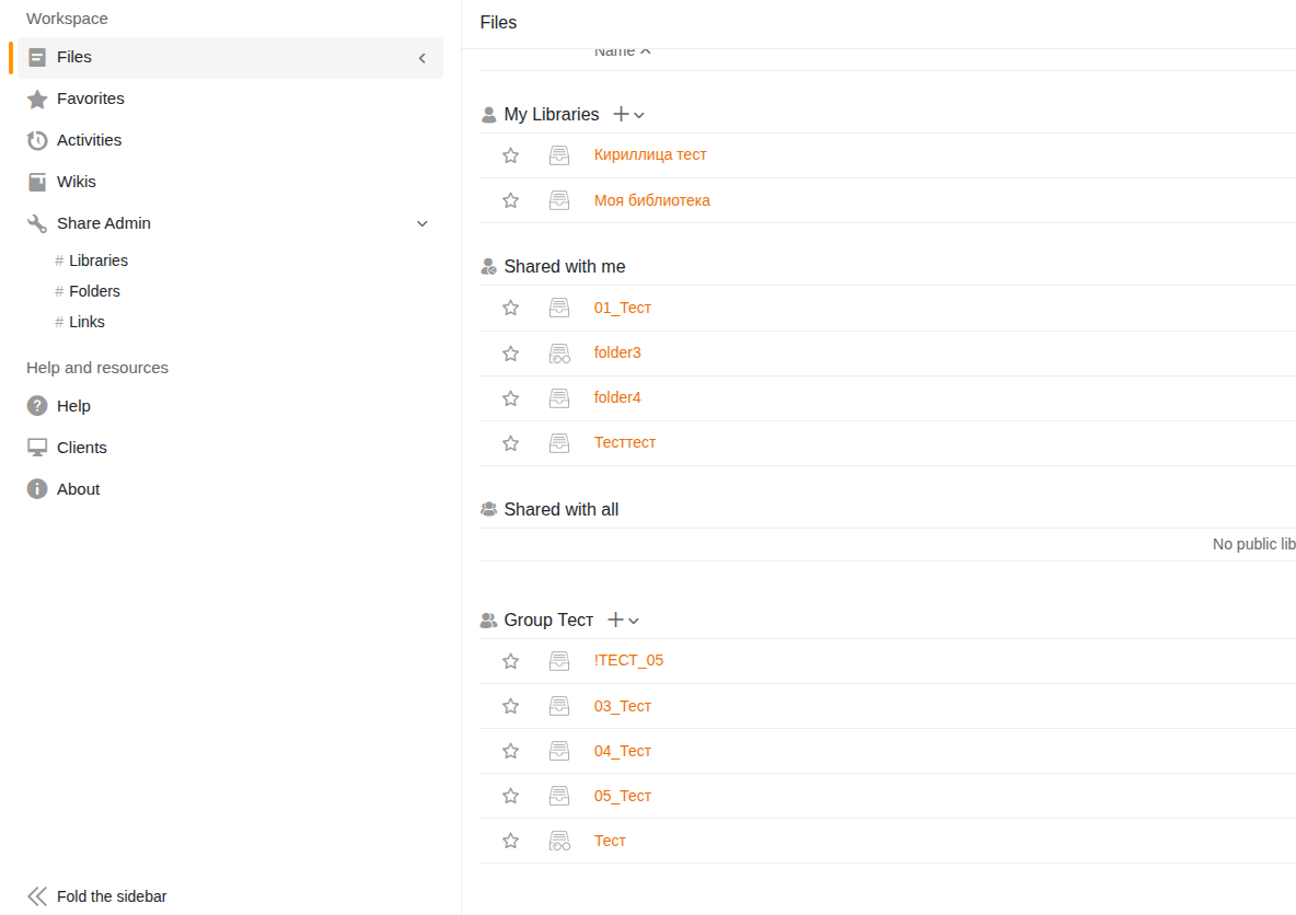

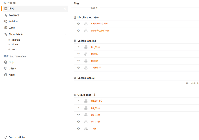

I’d like to provide some additional details from the user’s perspective.
The error when opening files occurs only in folder “04_xxxxx”.
There are no errors when opening files in “03_xxxxx” or “05_xxxxx”.
Please note that the folder is shared with the group “Group xxxxxx”, of which I am a member.

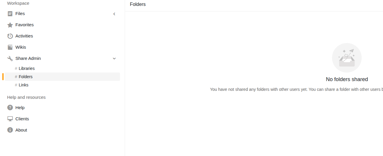

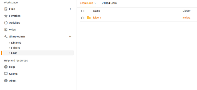

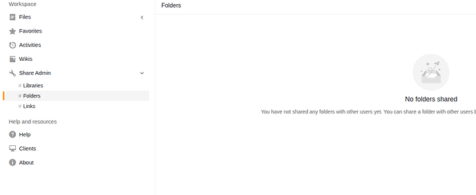

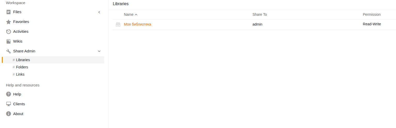

In “Share Admin”:

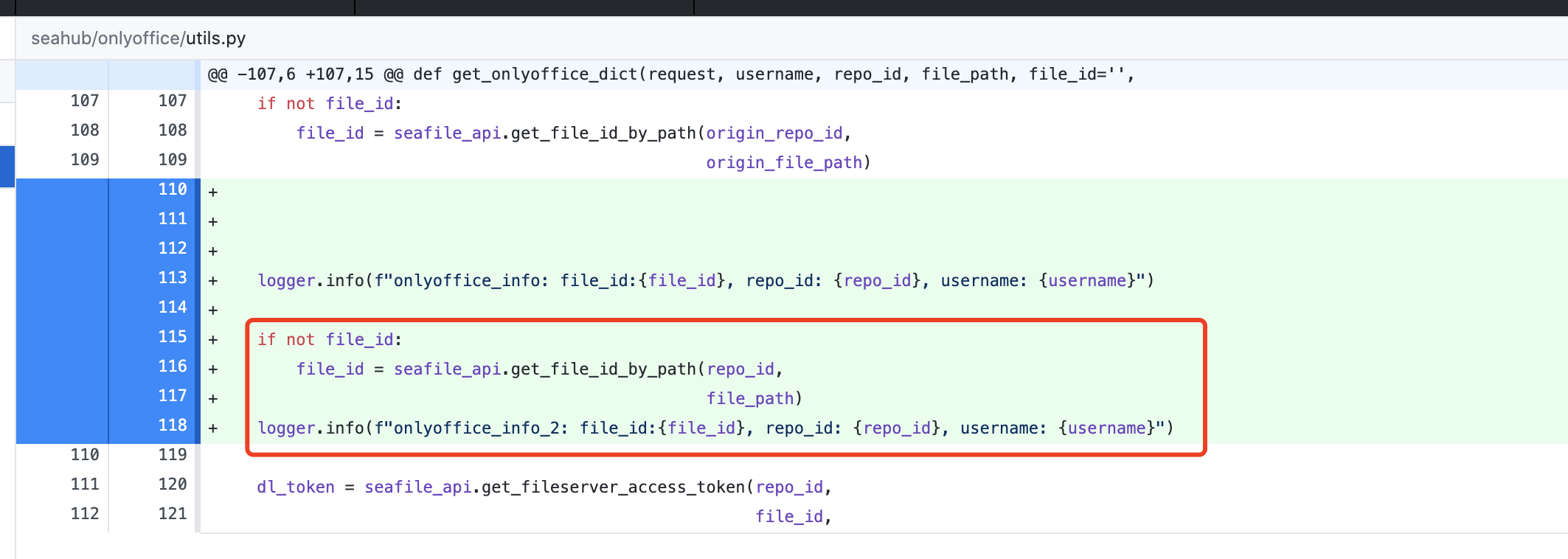

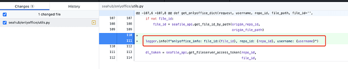

After adding the debug line:
logger.info(f"onlyoffice_info: file_id:{file_id}, repo_id: {repo_id}, username: {username}")
==> /opt/seafile-data/seafile/logs/onlyoffice.log <==
[2025-11-12 19:42:17] [INFO] onlyoffice:95 get_onlyoffice_dict 5d*****c2@auth.local open file /test.docx in repo 7fa*******a77 with can_edit True
[2025-11-12 19:42:17] [INFO] onlyoffice:111 get_onlyoffice_dict onlyoffice_info: file_id:None, repo_id: 7fab
******a77, username: 5d22ff******f82c2@auth.local
In System Admin → Libraries, the library that causes the problem does not appear.
In the “Libraries” tab, I can see only the root folders, not the subfolders (perhaps that’s expected).
However, when I go to System Admin → Groups → Libraries, I can see the folders shared with the group — those are the same folders that appear on the user’s main page.

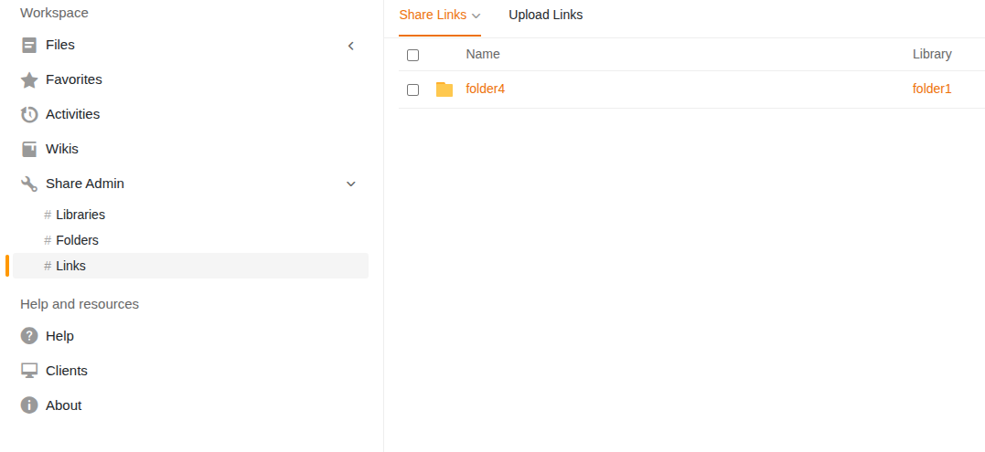

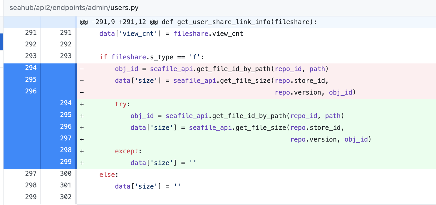

I also found another issue for the user who is both the owner of the group and the owner of the library:
In System Admin → Users → username → Shared Links, the page loads, but in the browser’s debug console I see a 500 Internal Server Error for one of the requests.
==> /opt/seafile-data/seafile/logs/seahub.access.log <==
[12/Nov/2025:20:04:33 +0300] “GET /api/v2.1/admin/users/e207382af310fc2f%40auth.local/share-links/ HTTP/1.1" 500 285 "https:///sys/users/e2**********10fc2f%2540auth.local/shared-links” “Mozilla/5.0 (X11; Ubuntu; Linux x86_64; rv:144.0) Gecko/20100101 Firefox/144.0” 0.091

We have reproduced the issue in Sysadmin-user-share-links—this problem is caused by invalid share links that contain an invalid file. We will work on fixing this, and in the meantime, you can use the following temporary workaround:

Based on this context, here is a small piece of debug information you can add to your code to further verify the workflow:
Fixing the issue with “Shared Links” helped. Thank you.

After making the changes to utils.py, the situation is as follows:
As a user and as a member of the group “Group 1”, I can open the file test.docx, but when I try to edit the file, an error appears in the logs:

Debug:
[2025-11-16 16:33:53] [INFO] onlyoffice:95 get_onlyoffice_dict 5d22ffaxxxxxxxxxxxxxxf82c2@auth.local open file /test.docx in repo 7fab7xxxxxxxxxxxxxxxxxxxx92a77 with can_edit True
[2025-11-16 16:33:53] [INFO] onlyoffice:111 get_onlyoffice_dict onlyoffice_info: file_id:None, repo_id: 7fab78xxxxxxxxxxxxxxxxxxxx92a77, username: 5d22fxxxxxxxxxxxxxxxxxxx2c2@auth.local
[2025-11-16 16:33:53] [INFO] onlyoffice:116 get_onlyoffice_dict onlyoffice_info2: file_id:37c72d6dxxxxxxxxxxxxxxxxxxxbe48a00, repo_id: 7fab788xxxxxxxxxxxxxxxxxxc92a77, username: 5d22fxxxxxxxxxxxxxxxxxxxf82c2@auth.local
[2025-11-16 16:33:53] [INFO] onlyoffice:146 get_onlyoffice_dict get doc_key c172cxxxxxxxxxxxxfbd65 from database by repo_id 2102c4dxxxxxxxxxxxxxxxxx9fe875a72 file_path /02_xxxx /03_xxxxxxx /04_xxxxxx /test.docx
It seems the target file can only be accessed from folder04 as a virtual repository, but fails to display in the main repository. This issue may stem from errors during the merge of changes from the subfolder (virtual repository) into the main repository—relevant merge errors might be recorded in seafile.log.
