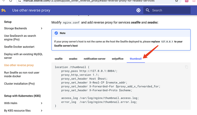

Have you forwarded /thumbnail requests to the thumbnail server via http protocol in your NPM config?
Thanks for your config! I will try that later. Glad at least someone got it working so I’m more confident :wink:
I think I did, but I’m not really good at NPM advanced config. By any chance you know how to configure this?
Thanks a billion for your help!
There is an example for proxying thumbnail server for Nginx:
Thanks for the info, it’s helpful for me!
