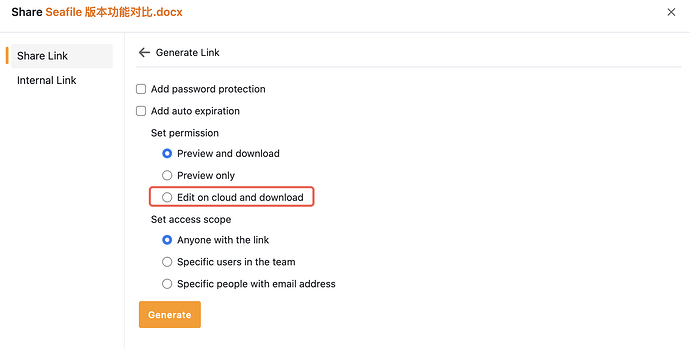

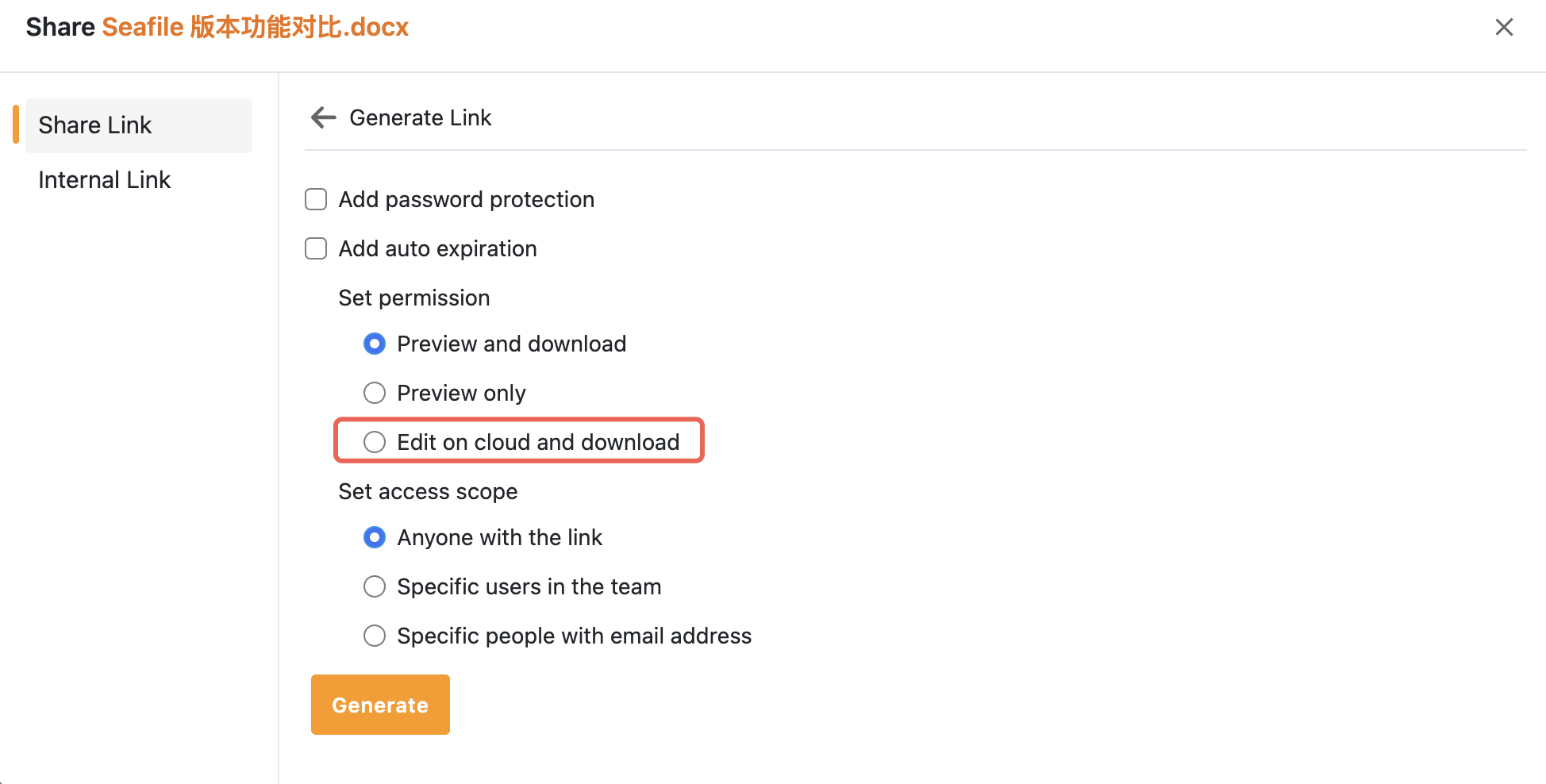

When creating a share link, you can set it as “editable”. In this way, your external users can also edit on the file.

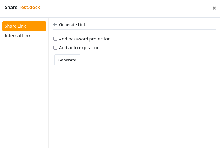

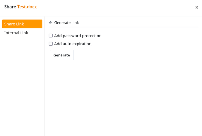

Where do I find this option? When I generate a share link the only options are password protect and duration.
Do you see this permission in the dialog generating sharing links for a docx file:

I see this when I go to share.
The version I am using is CE 12. I notice there is a version CE 13 in the docker repo, do I need to upgrade to 13?
I did some digging and I noticed that docker was reporting a different version than that of the info in Seafile. I purged the image and re-pulled it and now those options are showing. I’m not sure what caused this, but it is fixed now.
