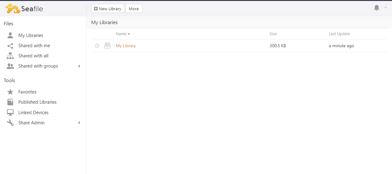

all i am seeing is this with a link
Barolo
March 2, 2022, 10:17am
6
Have you set up a reverse proxy? If yes, with which config? If not, which port are you using?
i have not set a reverse proxy up. The ports are default (for now) and the port which shows up (image above) is 8080
EDIT: believe it or not, i set up my no-ip and it came up with the login box for the web interface ive been trying to get (image below)
thank you again for your help
Barolo
March 3, 2022, 7:49am
8
FYI, 8080 is the default port for webDav (the first interface you’ve sent). Seahub (standard interface) is on port 8000
