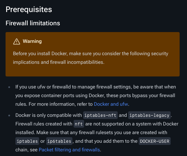

Edit 2:
I am wondering if it might have anything to do with the firewall.
I actually do use UFW and haven’t got IPTables installed. I am not used to work with that. I only open ports 22, 443 and 80 usually.
Could there be in issue with this of seafile docker containers talking to each other?

Hi
I did tons of checks and re and re and re-installations of various Debian and Ubuntu servers today.
The issue is simply the firewall.
If UFW is running during the first docker compose up -d ,then it causes the above issues.
If IP Tables is running, then docker adds various rules to the IPTables and the seafile server was running, but not reachable at all from the internet.
For me, my best solution at the time is to create a fresh server (can be Debian 13), then install docker according to the manuals but NOT install any firewall.
Once Seafile is started with docker compose up -d and works well, then install UFW and open SSH, HTTP and HTTPS ports and enable the firwall - and that works.
Also worked after a restart.
But it can be felt that the speed of the website is higher when no firewall is running. UFW causes a small lag. So there is room for improvement.
I assume in case someone wants to do docker compose down then UFW should be disabled prior to running Docker compose up -d again.
Again, this is the best I could do to make this work for me.

About Firewall (UFW):
While you mentioned opening ports 22, 80, and 443, ensure that UFW is not blocking the internal communication between Docker containers. Docker typically manages iptables rules directly to allow container-to-container traffic, but sometimes UFW rules can interfere with how Docker’s bridge network handles external-to-internal routing.
Personally we don’t have such issues in many of our managed installation. We don’t touch firewall settings at all.
I think including firewall related document to Seafile manual will make it quite complex, and is out of the scope of Seafile manual.
