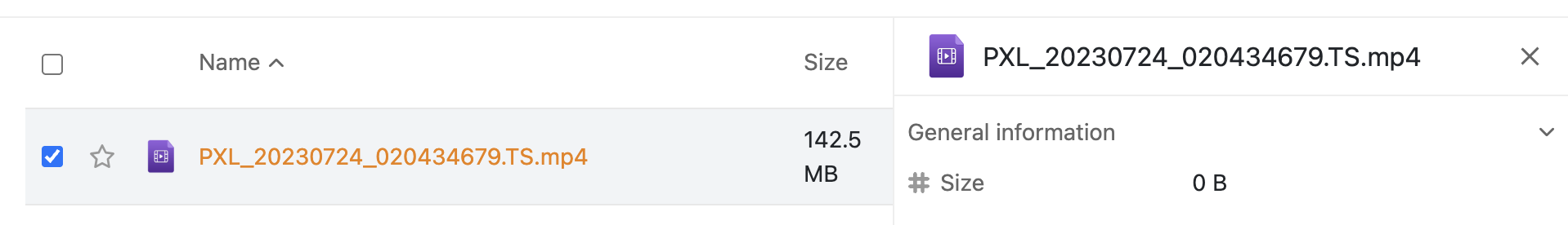

I have discovered several files that are reporting the Seafile UI as being XXX.X MB but expand the details, it shows as 0 B. When I download the file, I get an empty 0B file.

The file size is not zero, but its content is actually empty. This is usually caused by uploads from older versions of the mobile app. You can check the file’s modification history through the library’s history and try restoring it from a historical snapshot.
If it cannot be restored from the snapshot, the file cannot be recovered because it is missing blocks.

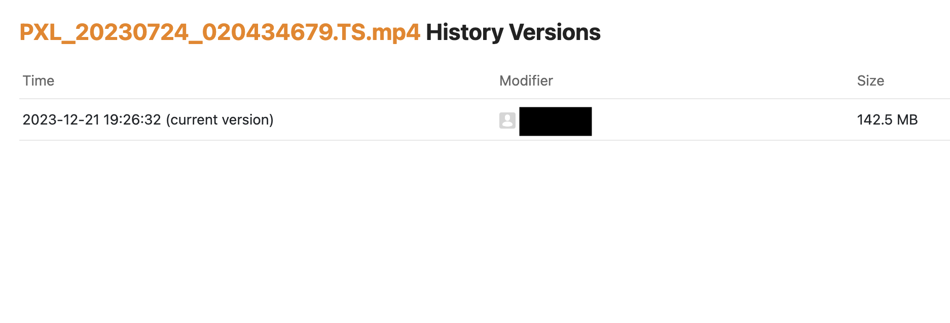

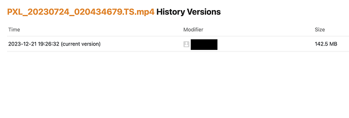

This is very bad. As shown in the screenshot, there are no prior snapshots on these files. They were valuable pictures that I expected Seafile to save. It silently failed on me and went undetected for 2 years.

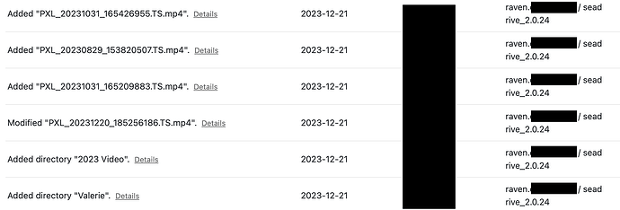

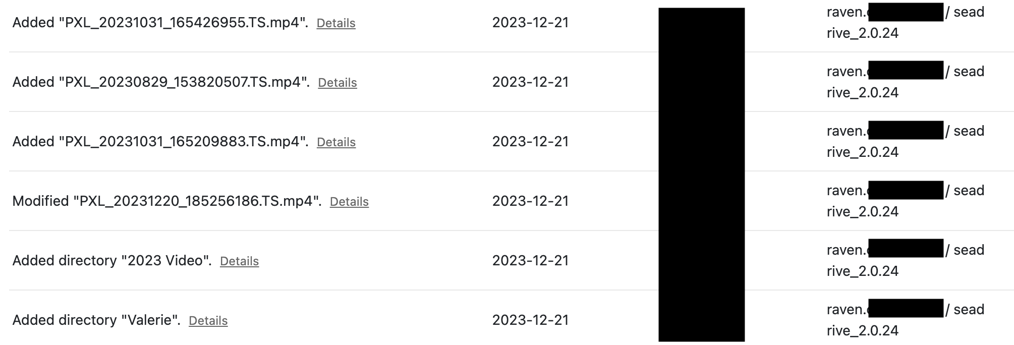

This was with seadrive_2.0.24 on Mac.

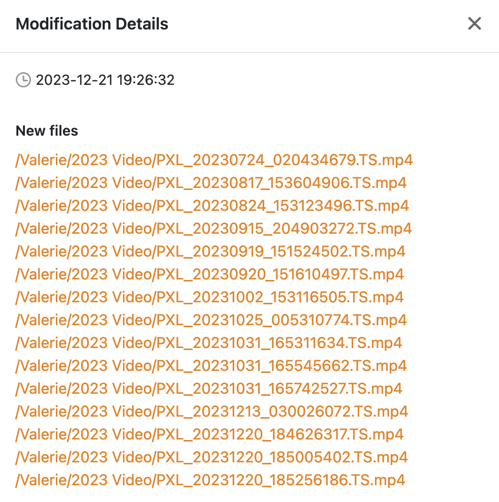

Hello @j1a2o ,
Could you please send a screenshot of the record of a corrupted file in the library history? This will help me understand what actions the client performed based on the history. Thanks.
Many of the files in the “2023 Video” directory are lost.
After analyzing the code of SeaDrive 2.0, this issue is possibly caused by special timing of the file system events sent from the macFuse extension. SeaDrive 2.0 uses a third-party kernel extension called macFuse to implement the virtual file system. When copying a lot of files into the virtual drive in a short time, such event timing can happen more easily. The code in 2.0 doesn’t handle such event timing correctly and may cause the issue you report.
We’re currently not able reproduce the issue though. We think it shouldn’t be a very common issue. In SeaDrive 3.0, we don’t use macFuse so this issue should not happen.
