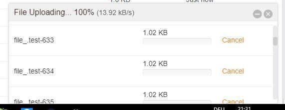

I created 1.982 files with the size of 1kb.
The size doesn’t matter. Uploading was faster only.
Then I uploaded them via browser (Chrome on Win10).
On another client computer I checked the amount of files that were synced.
And guess what? There were not 1982 files. Only 1227 arrived there.
The upload dialog in the right lower corner said: saving…

Above 600 files no seafile server got the message: Upload completed. (in browser gui)
Even on all different Seafile Versions the Upload with 600 files can’t completed.
Via Seafile client everything works fine.
Yes I 've set MAX_NUMBER_OF_FILES_FOR_FILEUPLOAD = 4000 in seahub_settings.py
Sometimes in the Browser Upload window is: Unknown error or Access denied.

398 files added to upload queue - 398 arrived online - perfect!
399 files added to upload queue- ONLY 365 arrived online - Browser says: saving…
