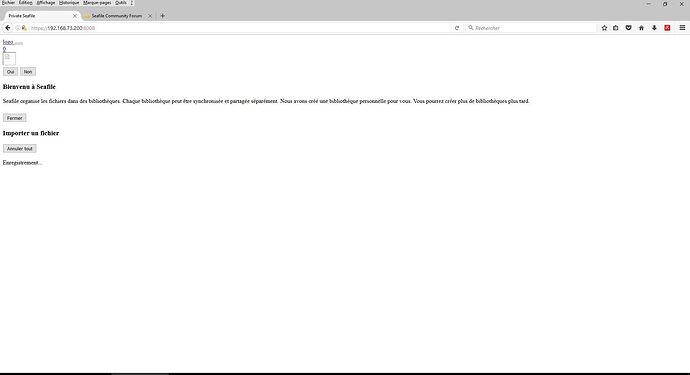

I have a problem when I connect with my firefox seafile server I have this page that appears, and it is impossible to see my bibliotheques.look this picture attached which will be easier to understand.
I have this problem on 3 computer and Iphone.
Can you help me. thank you very much.
I use Seafile server 6.0.4, with Https and Nginx on Ubuntu 16.04 LTS
regards
this looks like seahub can’t read the media directory. What are your logfiles saying?
Is the whole seafile folder on your server owned by the user ‘seafile’?

Yes. Jack did. What about his questions?
Hello,
Thank you for your reply
Yes my seafile folder is user “seafile”
Seahub.log is empty
here is my other log file.

error log (on var/log/nginx):
2016/09/29 15:53:55 [error] 14066#14066: *112 open() “/home/thierry/seafile/seafile-server-6.0.4/seahub/media/assets/css/bootstrap.min.b00faad199b5.css” failed (2: No such file or directory), client: 192.168.73.118, server: seafile, request: “GET /media/assets/css/bootstrap.min.b00faad199b5.css HTTP/1.1”, host: “192.168.73.200:8008”, referrer: “https://192.168.73.200:8008/accounts/login/?next=/”

I found myself.
I had to change the server version in etc / nginx / sites-enabled / seafile.conf
maybe you should not use server version directly, use seafile-server-latest instead
location /media {
root /home/user/haiwen/seafile-server-latest/seahub;
