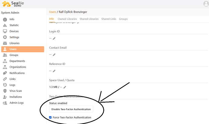

So the next question is how do you get back to this set-up screen when you’ve got a new phone/lost the account in the authenticator app? Don’t forget that one can’t logon at this point… although I do have access via the admin account.
Thanks - that works a treat.
Wonderful. Can you mark as solved?

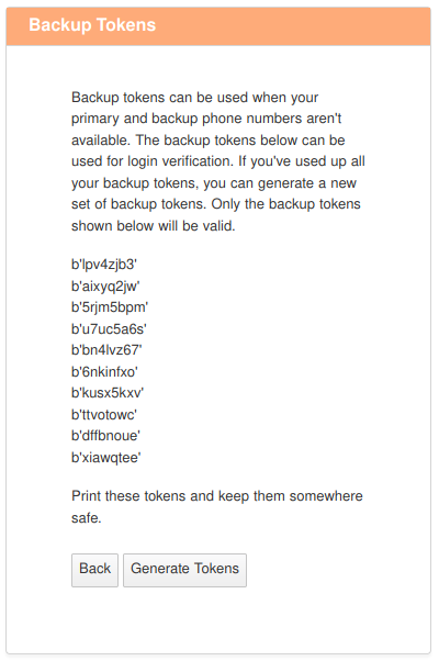

After you enabled 2FA the next page shows you this
I am sure you followed the instructions and kept your codes somewhere safe!
P.S.: This is a screenshot from 8.0.5 pro. The output looks a little broken to me.

Except when I tried them, they didn’t work. I’ll try again on a test VM. You do type them into the same box when it prompts for the 2FA?

Ahh just noticed this - same version here and yes, there is another post on here about how the output is broken. That needs fixing ASAP. Assume that’s why my backup codes don’t work.
https://forum.seafile.com/t/seafile-pro-8-0-3-2fa-broken/14386
