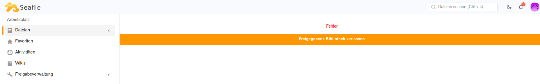

Hello, I’ve been trying to update from version 12.0.19 to version 13.0.16 for quite some time now.
The update itself works, but I can’t open the library in version 13.0.16 using a web browser; I keep getting an error message.
The server is not running as a Docker container.
Perhaps someone else has encountered this problem and can help me.
I think I’ve found the error: an update warning for the MySQL database. This appears when I try to run the update script from version 12 to 13. I’m just not entirely sure what exactly needs to be changed or edited to fix it.
