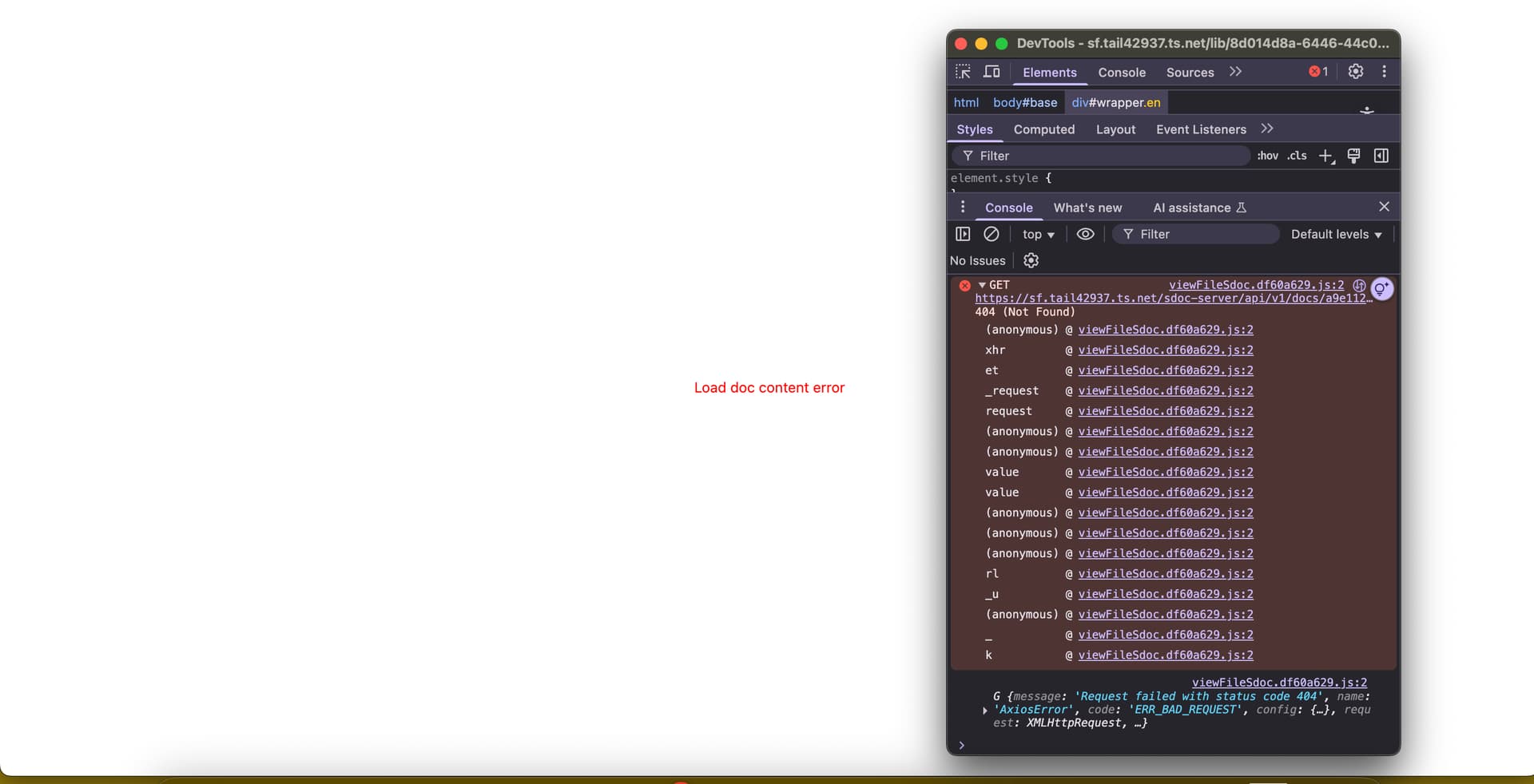

Error opening SeaDoc document
Newly setup Seafile Server and SeaDoc. This is the error I’m getting on my browser. My full config is available on GitHub. You can see all of the environment variables that are setup for my containers in that config already. I can also translate from Nix to Podman quadlet configs or provide any detail that may be necessary to help debug this.

I made the fixes you suggested. I’m getting the same error. Additionally, I opened up the console and tried to opent the URL that’s throwing an error directly and got this error: {“error_msg”:“You don’t have permission to access.”}.
Does SEAHUB_SERVICE_URLhave to be the internal one like seafile:4000 or the external one like seafile.external.url?
Looks like seahub is able to authenticate with sdoc-server. The request in my browser console uses an auth token and gets a different response from the one I get directly accessing the URL.
I’m getting this in the browser: Cannot GET /sdoc-server/api/v1/docs/3137cc78-380c-4f5a-8b1c-abc445c78175/, with a response code of 404.

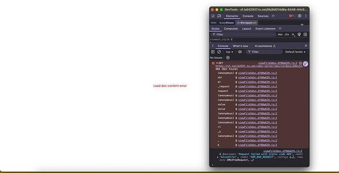

I fixed the routing. The request is answered by an express server now, which can only be the seadoc server.
HTTP/1.1 404 Not Found
Access-Control-Allow-Headers: Content-Type, Authorization, Accept
Access-Control-Allow-Methods: DELETE,PUT,POST,GET,OPTIONS
Access-Control-Allow-Origin: *
Content-Length: 200
Content-Security-Policy: default-src 'none'
Content-Type: text/html; charset=utf-8
Date: Tue, 02 Sep 2025 19:22:42 GMT
Via: 1.1 Caddy
X-Content-Type-Options: nosniff
X-Powered-By: Express
Glad to see that the request is now correctly route to sdoc-server.
Then, what error do you have in sdoc-server’s logs?
