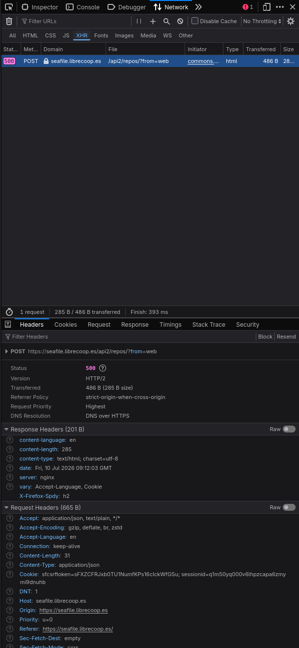

Errors on library creation/deletion after migration to Seafile 13
We recently migrated a couple of instances from Seafile 12 to Seafile 13 (1 comunity and 2 pro). It all seemed to be working fine but today when I wanted to create a new Library the server returned a 500 error. When I refreshed the page the library was there. If i delete it I get an error too but the library disappears. I have not been able to find an error in any of the log files. Is this a known problem?
To pinpoint the exact cause, we need to examine the logs that capture application-level tracebacks. Please check the following log files and share any errors or “Traceback” messages found around the time you performed the action:
  • logs/seahub.log
  • logs/fileserver.log
  • logs/seafile.log
You can also check Nginx/Caddy proxy log to identify which part return 500 HTTP response.
The error, for example happens when making a POST request to
This error apears constantly in seafile-monitor.log (next message it doesnt fit in this one)
