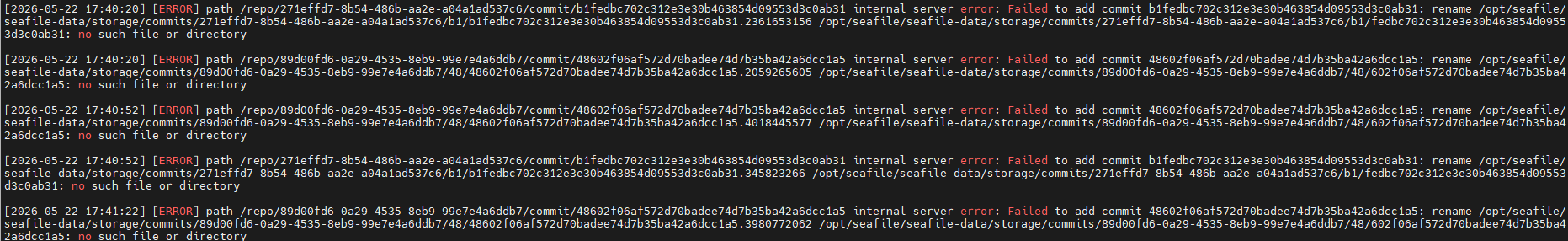

When I upload a file, the sync fails. The error information is shown in fileserver.log:
but downloading files works properly.

The error “Failed to add commit, rename fail” in fileserver.log typically indicates that the Seafile fileserver is unable to move a temporary commit file to its final destination in the storage backend. Since downloading works, your read access is functional, but write/rename operations are failing.
Running seaf-fsck.sh --repair is a good practice to ensure repository integrity, but it may not solve this specific error if it is caused by system-level issues.
Please check the following on your server:
  1. Disk Space and Inodes: Ensure the partition where your seafile-data is stored is not full.
    • Check space: df -h
    • Check inodes: df -i
  2. Permissions: Verify that the user running the Seafile process has full write and ownership permissions for the seafile-data directory and all its subdirectories.
    • A common fix is: chown -R seafile:seafile /path/to/seafile-data (replace seafile:seafile with your actual user and group).
  3. Filesystem Status: Check if the filesystem has been remounted as read-only due to an error. You can check this by running mount or looking at dmesg output.
  4. Storage Backend: Are you using local storage, or is your seafile-data on a network share (NFS, SMB) or object storage (S3, Ceph)? If it’s a network share, there might be a latency or locking issue.
