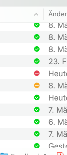

More other, I’m not expecting these cloud-icons, like in Jonathans post, but more these green/orange/red checkmarks (see picture below).
Even though, his solution can’t contribute to my situation here, in my point of view.
Best, Chris
