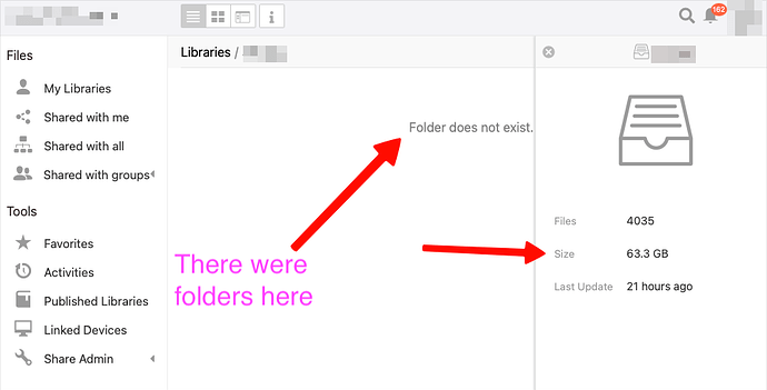

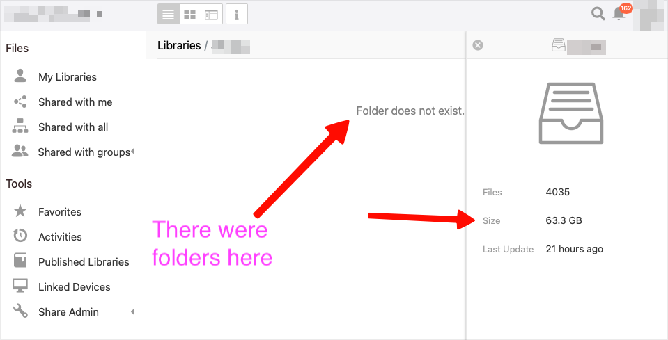

I have a big issue here - first time that this happens to me in 12 years.
I have an account that has a library - let’s call this admin account.
Inside that Library there are/were several folders.
I am sharing those folder with other accounts - user accounts.
These folders somehow now got lost on the admin account.
It still states a specific size though:

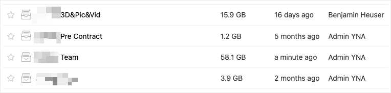

One of the 3 shared libraries that came back can’t be downloaded.
At about 11:20 am below you can see the rror message.
Is there something else I can do?
The Library is called “Project Team”.
The seafile.log file shows the below. The FSCK happened on 27/03 in the morning (10am).
