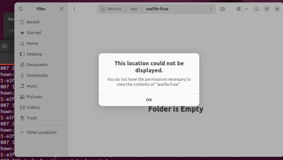

Struggling with this, Fuse starts, but I when I visit the folder to view files /opt/seafile-fuse I get a permissions error.

Thinking a ownership issue errored - sudo chown -R root:root /opt/seafile-fuse
bunny@bunny-pc:/opt/seafile$ sudo chown -R root:root /opt/seafile-fuse
[sudo] password for bunny:
chown: changing ownership of '/opt/seafile-fuse/67d291f462324166a4fd0ad30c9d4362@auth.local/61a03ca0-09b9-4ed1-a3f3-726851e10abe_ClientAccess/test': Function not implemented
can’t even cd into it
bunny@bunny-pc:/opt/seafile$ cd /opt/seafile-fuse
bash: cd: /opt/seafile-fuse: Permission denied
cant set permissions either, chmod isn’t implemented either - same Function not implemented error
any clues?
