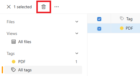

just open the library, where the tag is defined, go to “All tags”, mark the tag and click on the trash bin icon. Or use the right mouse button on the tag and chose “Delete tag” from the menu.
That’s how it works for me :slightly_smiling_face:
Dirk
