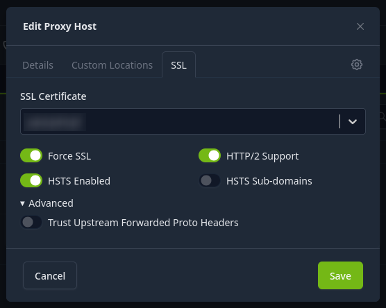

As for SSL panel, I have the following:
The following has also to be added to seahub_settings.py otherwise the site fails to load after login.
CSRF_TRUSTED_ORIGINS = ["https://seafile.example.com"]
