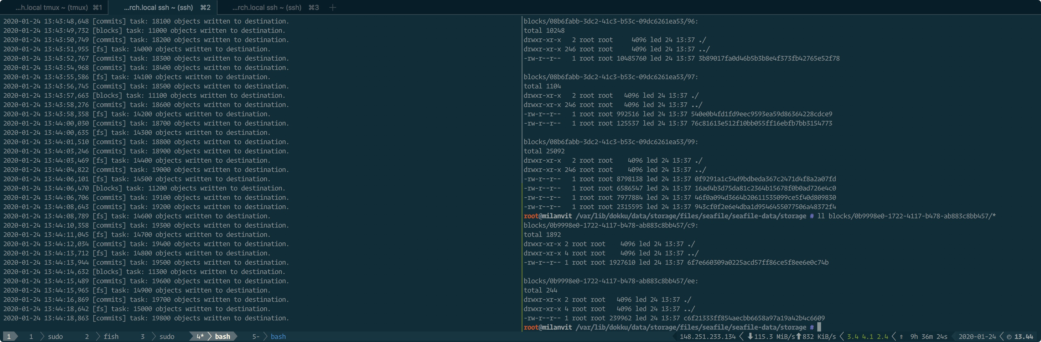

I… think the migration script might actually be working :flushed:
On the new server, I restored MariaDB from back-up created on the old server, and copied all the Docker persistent storage data (incl. conf/seafile.conf pointing at S3). Then I entered the container (in my case, that’s as simple as dokku enter files, since I run most of my apps via Dokku), and after executing these commands…
mkdir migration
export OBJECT_LIST_FILE_PATH=/opt/seafile/migration/file
touch /opt/seafile.conf # That’s right, empty config file here!
cd seafile-server-latest
./migrate.sh /opt
… this is the result I’m seeing:
It’s definitely downloading (filenames and sizes are matching compared to my S3 storage), and as you can see in the bottom right, it’s going crazy fast (100+MB/s). I’ll report back once the script has finished running!
Edit: also, as you can see from the screenshot, it is also renaming the files/folders to match the local filesystem structure that Seafile uses. It’s exactly like @shoeper mentioned in the beginning, the first two characters are extracted from the filenames and turned into a folder name.
