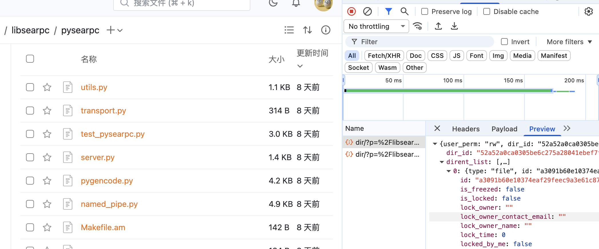

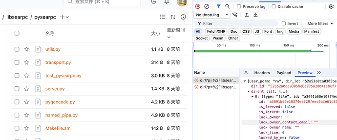

First, open the directory containing the file that was previously reported as corrupted. Then open the browser’s Developer Tools. After refreshing the page, you should be able to see the relevant request in the Network tab (as shown in the screenshot). From this request, you can obtain the file’s obj_id.
Next, use the file history to access the snapshot from when the file was first uploaded in a corrupted state. Using the browser’s Developer Tools again, obtain the obj_id of the same file from that snapshot.
Compare the two obj_id values:
  • If they are the same, it indicates that the file was uploaded to the server correctly and completely. In this case, the problem is more likely related to writing the file blocks to storage or to the actual download process experienced by the user.
  • If they are different, it indicates that the file was already corrupted when it was uploaded to the server. This suggests that the issue may have occurred during the file transfer process.
Please compare the two obj_id values first to determine which scenario applies.

Thank you for these steps. I’ve verified that the two ids are the same for the corrupted file as it is currently and the corrupted file as it was in the snapshot it was uploaded in.

If the IDs of the two files are identical, it indicates that the chunking used during the previous upload and the current one is the same. This is because the obj_id is calculated based on the file content.
Therefore, the issue is likely caused by a download error. You can check the Nginx logs during the download after the file upload has completed, and verify whether the returned file size matches the actual file size.
Oh sorry, I think I misunderstood. You wanted me to compare the obj_id of the successful upload of that file vs the corrupted upload. I will have to get back to you on that.
Alright, I’ve determined that in actuality, these two files (the corrupt version and the non-corrupt version) have two different obj_ids.
