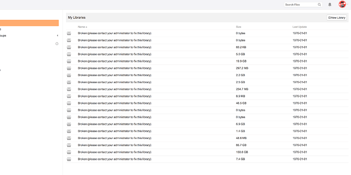

ok, uploading the folder to the s3 buckets is not really working :slight_smile:
That is the result:
Pretty much looks like there has been some error case that wasn’t handled and thus not all data has been uploaded to s3.
