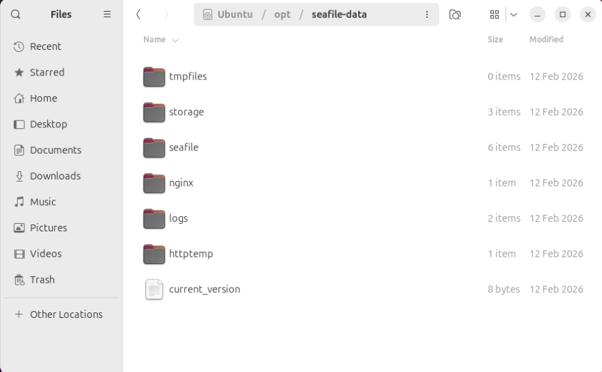

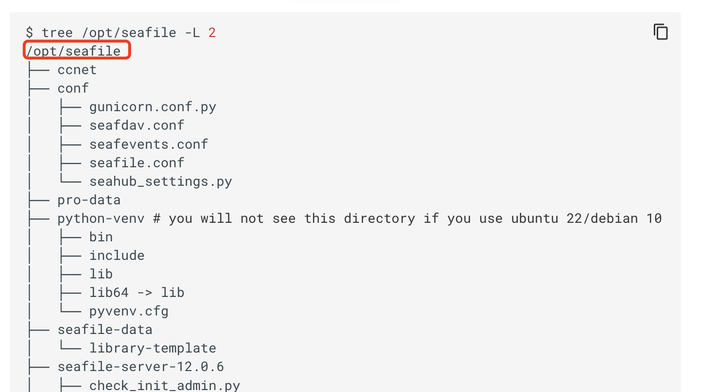

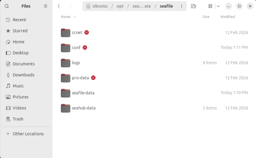

  2. The /opt/seafile-data/seafile folder is mostly red Xs except for logs/seahub-data - seafile-data folder can’t be accessed, except via sudo terminal. There is data in it so do I just delete all this and mount my /mnt/SFData folder in its place?
    This post suggests mounting my data folder over top of the existing folder, I assume by modifying the fstab file

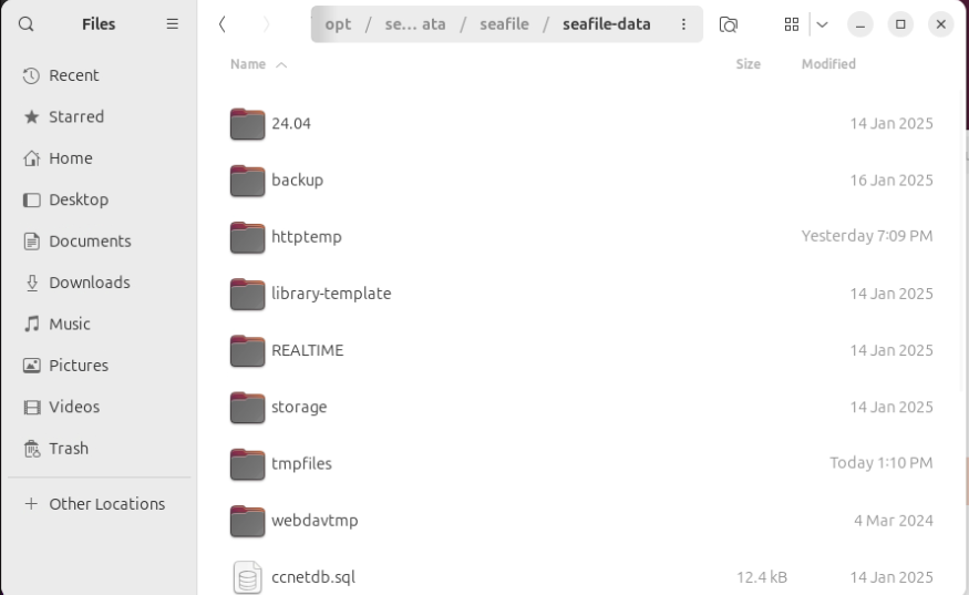

For Question 1 - I was able to resolve by modifying the fstab entry mounting directly to /opt/seafile-data/seafile/seafile-data and setting uid=0,gid=0 for root…
//nas.local/_myData$ /opt/seafile-data/seafile/seafile-data cifs uid=0,gid=0,file_mode=0755,dir_mode=0755,credentials=/etc/credential 0 0
This mounts the folder in place of local folder. Which also negated the need for extra line in seafile-server.yml (The issue in Question 2) ie the extra line below ${SEAFILE_VOLUME:-/opt/seafile-data}:/shared - removed that and now seafile appears to start ok

Could you also have a look at my directory structure please - it seems a bit funky as well
Top Level of Seafile-data
Seafile folder - inside this image below is the seafile-data folder mounted via fstab from my other install…
My actual seafile-data folder
This storage folder above contains my blocks, commits and fs folders
I’m seeing similarities between the first and last images which makes me think i may be mounting it in the wrong place.

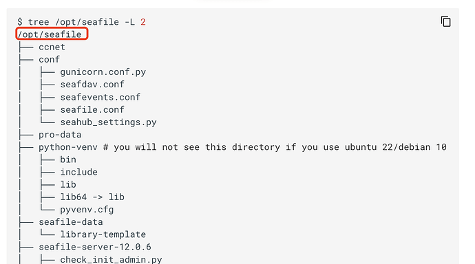

The suggestion way to Migrating from non-docker version to docker version is following this document: Migrate from non-docker deployment - Seafile Admin Manual
First you setup a running new Docker based deployment. Then you restore MySQL database and then copy the older contents in seafile-data to the new seafile-data.
Note, there are two levels of seafile-data that causing confusing. The first level seafile-data is for mount into the docker container (it can be renamed to seafile-volumn to avoid confusing). This is the folder shown in your first screenshot.
The second level seafile-data is under /opt/seafile-data/seafile/seafile-data. It contains only seafile commits/fs/blocks.
In you binary setup, if you deploy it under /opt/seafile. You directory looks like:
In docker based setup, if you deploy it under /opt/seafile-data. You directory looks like:
/opt/seafile-data (This can be better called seafile-volumn)
    -- seafile
    -- logs
Look, you should copy the contents under “/opt/seafile” in binary setup to “/opt/seafile-data/seafile” in docker setup.
In summary, you should focus on the seafile folder that contains seafile-data, configuration folder and other things. Not the second level seafile-data, which only contains commits/fs/blocks.
Be sure to copy all contents of /opt/seafile (binary setup) to /opt/seafile-data/seafile (docker based setup).
