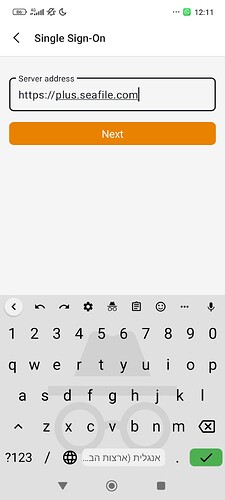

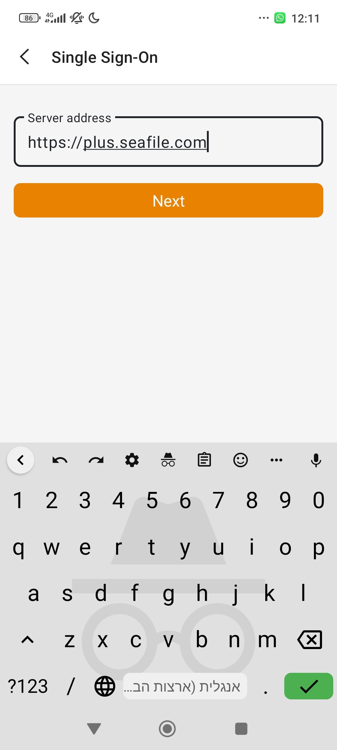

Hi, I am very new to seafile and I tried to conect my web acount to the mobile app.
I dont self host seafile (dont understen it yet) so I assumed that the server adrres is the weDAV.
The problam is when I put the URL insted of letting me in or tell me that Im wrong the app stats that it srupps runing.
can anyone help me with bouth problams?

Here is the document on install the syncing client: Seafile Plus Manual
For the server address part, you should use https://plus.seafile.com
thank you very much! :pray: it works

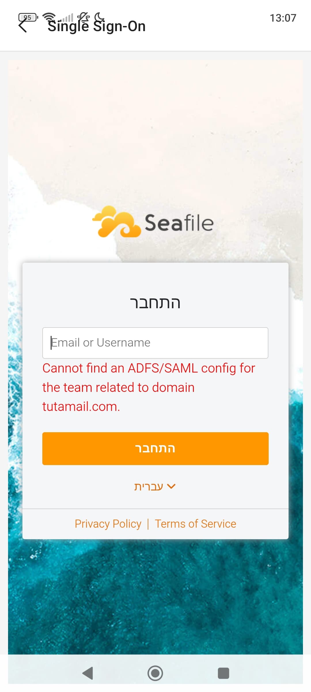

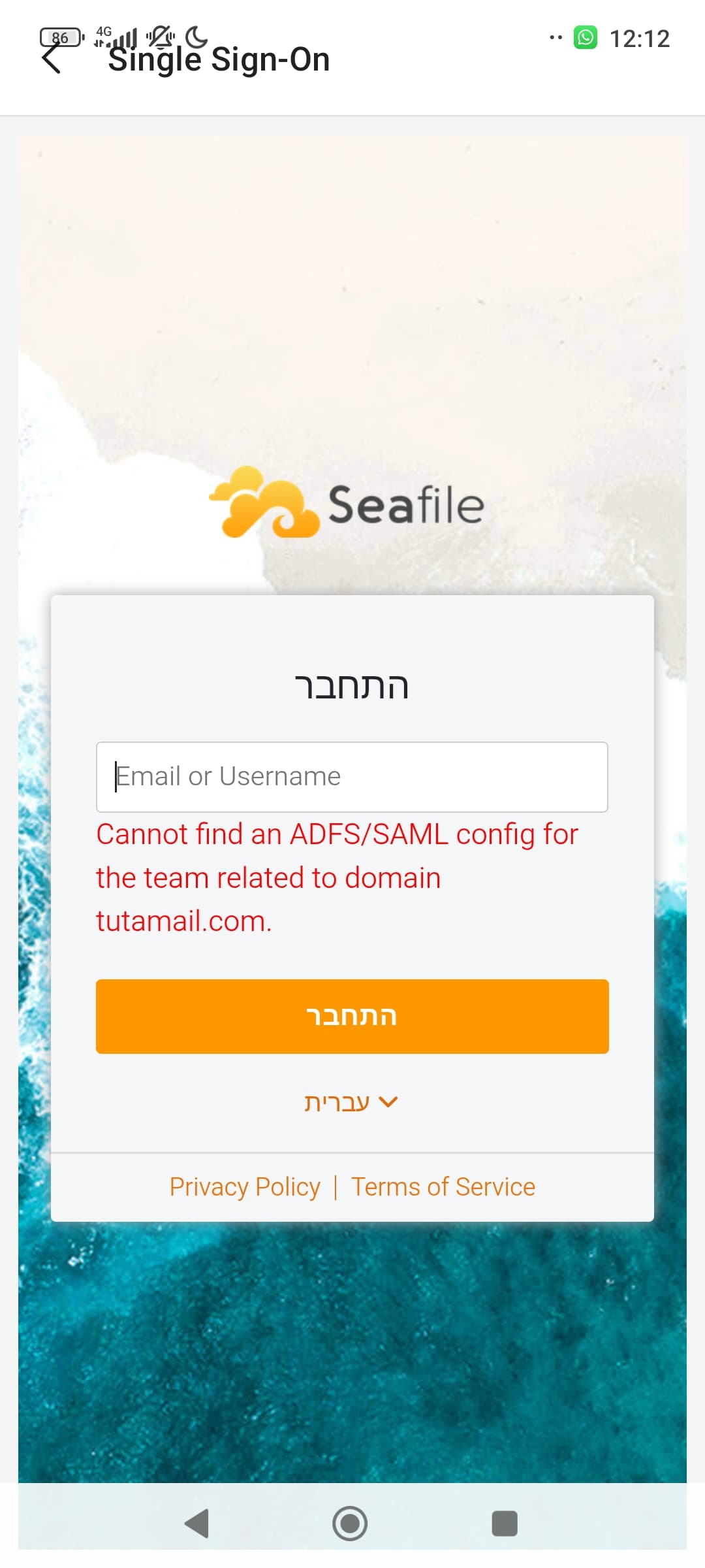

But now is says it doesnt have ADFS/SAML config my mail domain. But the web verion of seafile is ok with my mail and doeas interects with it.
can you hwlp me with that?

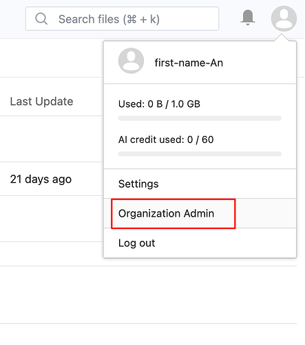

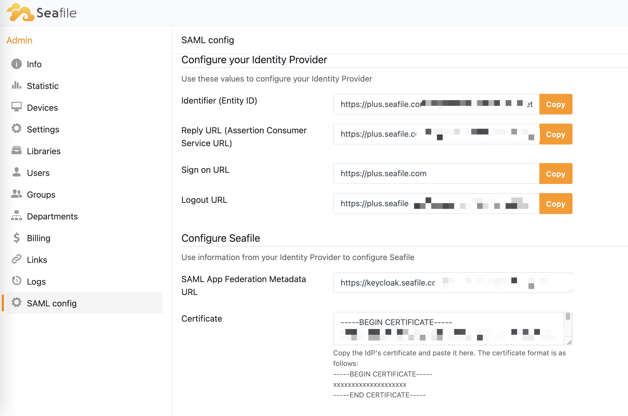

Hello, if you are using plus.seafile.com and want to use the ADFS/SAML single sign-on function, you need to configure the SAML config in the administrator interface.
Otherwise, an error “no ADFS/SAML config” will be reported.

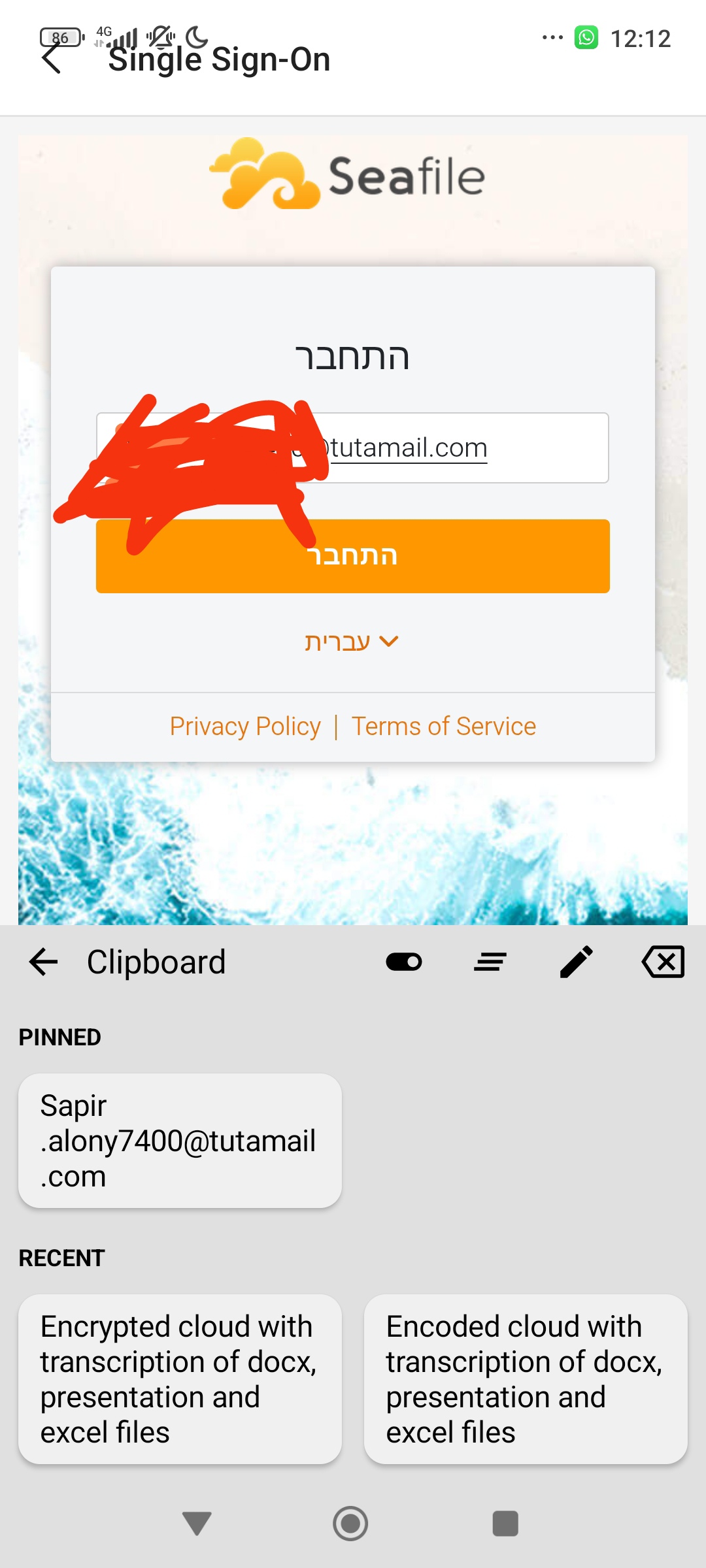

Hi, I use seafile plus
I dont have the SAML option in on the screan
The screanshote of teh error:

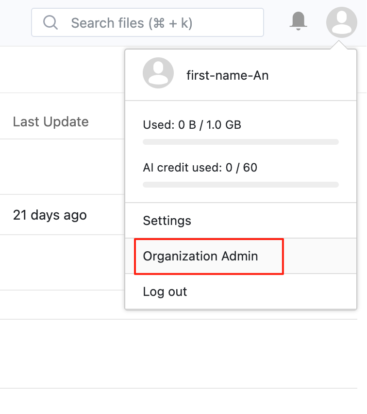

The SAML config can only be configured by administrators and is not currently available to ordinary users.
For now, you can only log in with your username and password.
Please do not use single sign - on for the time being.
When this feature is available in the future, you can configure it through the Organization Admin page.

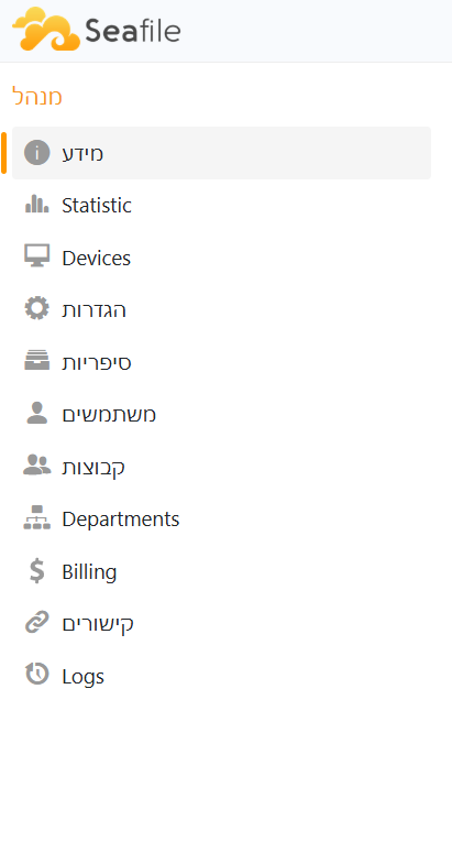

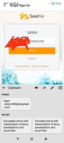

I dont have the SAML opation:
It is normal that you don’t have SAML option.
If you login with username/password, you should not have such an error “it doesnt have ADFS/SAML config my mail domain”.
If you still have the issue, can you paste screenshots of the steps you used?
In your screenshot, you want to login via mobile client.
In this case, when you prompted to choose a server, you should choose “Other server” instead of “Single Sign-On”
After choosing “Other server”, you can input https://plus.seafile.com as the server address.

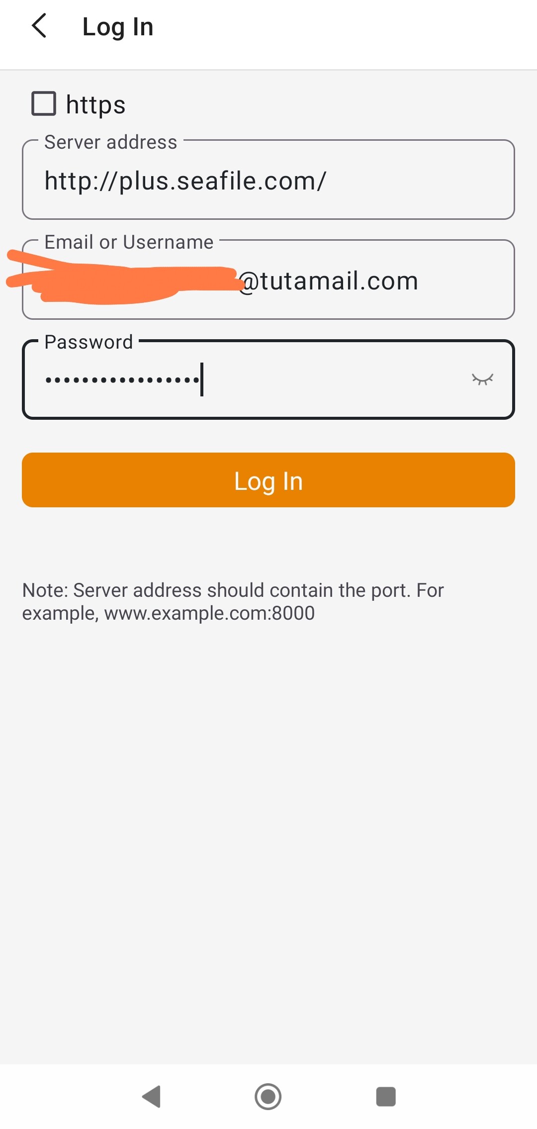

It says it needs a nunber after the URL
Turn the “https” check on. The address is https://plus.seafile.com
You don’t need the number part because plus.seafile.com using standard https port.
Thank you very much!!
It works :tada:
