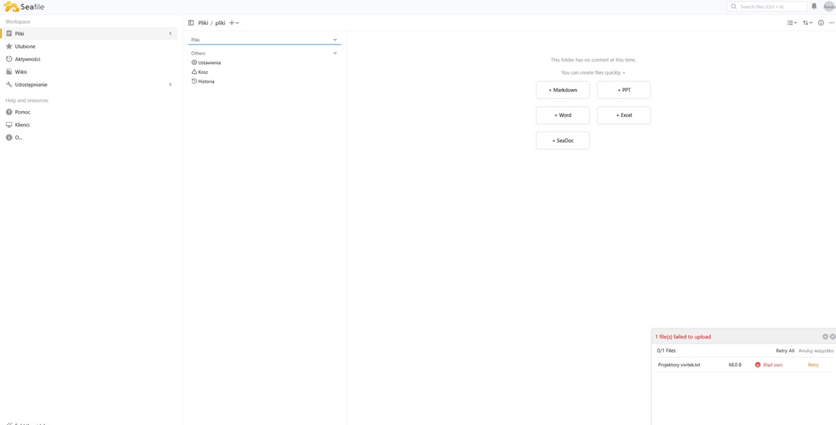

Hello when I want to send a file to the cloud I get a network error . As in the attached image

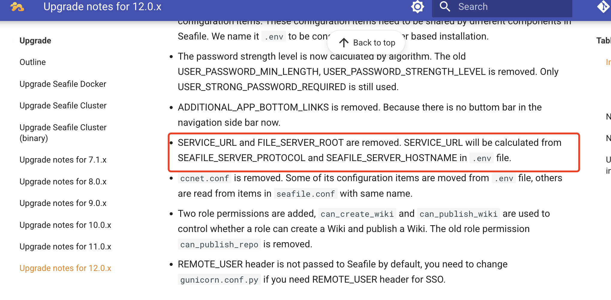

SERVICE_URL and FILE_SERVER_ROOT is no longer used in Seafile version 12.0.
I suggest you correct this part first. Then you can check chrome’s developer console to find detailed error about the network problem.

in the console I saw when uploading the file that:
“https://mydomain.com:8443/library/77665e01-aeec-4c25-a618-1d5180eb40df/pliki/ ” - this path is correct
here is not the correct path
“http://mydomain.com/seafhttp/upload-aj/f8f18b4a-19e0-414d-b3bd-56e3f18df ”
It looks like there is a redirection error in the nginx proxy server.
How can I solve this greetings.
