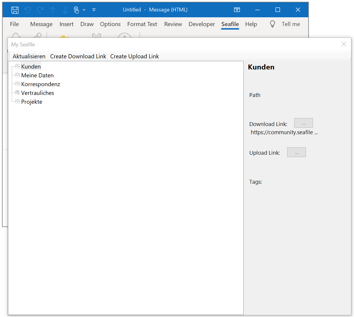

Integrate your favorite File Collaboration solution Seafile and Microsoft Outlook with the new Seafile add-in for Microsoft Outlook. A ready-for-testing version is now available for download at Plugin Integration | Seafile The add-in was developed by datamate, European Seafile Partner, and freelance developer Simon Giesen.
Features
The add-in supports:
  • Create sharing links (with password/expiration) directly from the mail window
  • Insert existing sharing links in emails
  • Upload file attachments to a folder/library
  • Upload an email’s as an HTML file to a folder/library
  • Switch to Seahub with one click - no login required

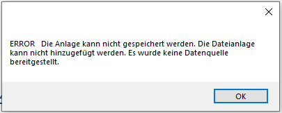

I’d like to use this tool, too. But I’m not able to Upload any Attachments to my Cloud. I always get the following Error-Message:
grafik
Do you have any Ideas?
Greetings :wink:
Hello. I have the same problem. How did you defeat her?
