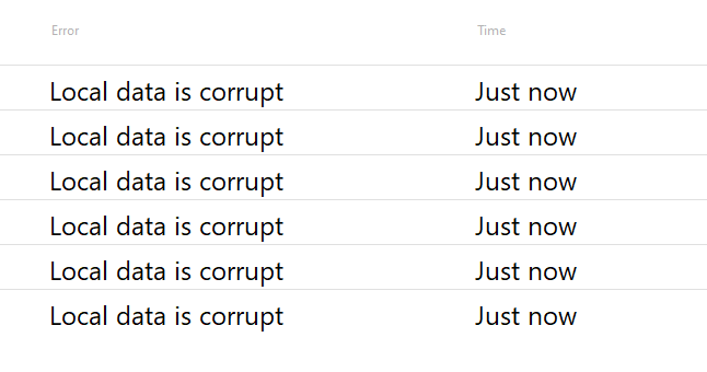

I am trying to set the root file on a microSD that is inserted in my surface pro laptop. However, it seems like seadrive does not like the microSD card and it is stuck at the fetching files process as shown in the figure below. Is there a way to resolve this?
I am installing sea client drive version 2.0.16 and the OS is window 10.
Thanks,
Fred

Hello,can you paste seadrive.log here?
This is what I found at the sync error. The log file also indicated some error
[08/15/21 14:44:44] Failed to register sync root D:\Seafile\fu-der.c: Do not attach the filter to the volume at this time…
[08/15/21 14:44:44] Failed to connect sync root for (my cloud drive account)
[08/15/21 14:44:44] Cloning repo Purchasing order(a64a02e1-65fb-43a6-a5a1-b0297b0403b0).
[08/15/21 14:44:44] Repo ‘Purchasing order’ sync state transition from ‘synchronized’ to ‘get token’.
[08/15/21 14:44:44] Cloning repo shared_files_files(0bef0e31-4f92-4b09-a98c-f2b3695e6dac).
[08/15/21 14:44:44] Repo ‘shared_files_files’ sync state transition from ‘synchronized’ to ‘get token’.
[08/15/21 14:44:44] Cloning repo Data Storage(97d4d6b0-73a3-444a-921f-1c63a97dda9d).
[08/15/21 14:44:44] Repo ‘Data Storage’ sync state transition from ‘synchronized’ to ‘get token’.
[08/15/21 14:44:44] Cloning repo My Projects(bcd18b11-29f4-4025-afeb-33b6745d909b).
[08/15/21 14:44:44] Repo ‘My Projects’ sync state transition from ‘synchronized’ to ‘get token’.
[08/15/21 14:44:44] Cloning repo Extracurricular(0a0243dc-8bea-4a37-b462-07e0f569f463).
[08/15/21 14:44:44] Repo ‘Extracurricular’ sync state transition from ‘synchronized’ to ‘get token’.
[08/15/21 14:44:44] Repo ‘Purchasing order’ sync state transition from ‘get token’ to ‘downloading’.
[08/15/21 14:44:44] Download with HTTP sync protocol version 2.
[08/15/21 14:44:44] Transfer repo ‘a64a02e1’: (‘normal’, ‘init’) → (‘normal’, ‘check’)
[08/15/21 14:44:44] [08/15/21 14:44:44] Download with HTTP sync protocol version 2.
Repo ‘shared_files_files’ sync state transition from ‘get token’ to ‘downloading’.
[08/15/21 14:44:44] Transfer repo ‘0bef0e31’: (‘normal’, ‘init’) → (‘normal’, ‘check’)
[08/15/21 14:44:44] Repo ‘Data Storage’ sync state transition from ‘get token’ to ‘downloading’.
[08/15/21 14:44:44] Transfer repo ‘97d4d6b0’: (‘normal’, ‘init’) → (‘normal’, ‘check’)
[08/15/21 14:44:44] Repo ‘Extracurricular’ sync state transition from ‘get token’ to ‘downloading’.
[08/15/21 14:44:44] Transfer repo ‘0a0243dc’: (‘normal’, ‘init’) → (‘normal’, ‘check’)
[08/15/21 14:44:44] Transfer repo ‘a64a02e1’: (‘normal’, ‘check’) → (‘normal’, ‘commit’)
[08/15/21 14:44:44] [08/15/21 14:44:44] Repo ‘My Projects’ sync state transition from ‘get token’ to ‘downloading’.
[08/15/21 14:44:45] Transfer repo ‘bcd18b11’: (‘normal’, ‘init’) → (‘normal’, ‘check’)
[08/15/21 14:44:45] Transfer repo ‘0bef0e31’: (‘normal’, ‘check’) → (‘normal’, ‘commit’)
[08/15/21 14:44:45] Transfer repo ‘97d4d6b0’: (‘normal’, ‘check’) → (‘normal’, ‘commit’)
[08/15/21 14:44:45] Transfer repo ‘a64a02e1’: (‘normal’, ‘commit’) → (‘normal’, ‘fs’)
[08/15/21 14:44:45] Transfer repo ‘0a0243dc’: (‘normal’, ‘check’) → (‘normal’, ‘commit’)
[08/15/21 14:44:45] [08/15/21 14:44:45] Transfer repo ‘0bef0e31’: (‘normal’, ‘commit’) → (‘normal’, ‘fs’)
Transfer repo ‘97d4d6b0’: (‘normal’, ‘commit’) → (‘normal’, ‘fs’)
[08/15/21 14:44:45] Transfer repo ‘0a0243dc’: (‘normal’, ‘commit’) → (‘normal’, ‘fs’)
[08/15/21 14:44:45] Transfer repo ‘bcd18b11’: (‘normal’, ‘check’) → (‘normal’, ‘commit’)
[08/15/21 14:44:45] Transfer repo ‘bcd18b11’: (‘normal’, ‘commit’) → (‘normal’, ‘fs’)
[08/15/21 14:44:45] Transfer repo ‘a64a02e1’: (‘normal’, ‘fs’) → (‘finished’, ‘finished’)
[08/15/21 14:44:45] Repo ‘Purchasing order’ sync state transition from ‘downloading’ to ‘load repo’.
[08/15/21 14:44:45] CfCreatePlaceholders failed on D:\Seafile/My Libraries/Purchasing order: The system cannot find the file specified.
[08/15/21 14:44:45] Repo ‘Purchasing order’ sync state transition from load repo to ‘error’: ‘Internal data corrupted.’.
I was able to have no error when I set the root file on my ssd, but I don’t have much space there so I prefer it to do it on my microsd.
Thanks,
feiniks
September 1, 2021, 8:30am
4
Hello,seadrive2.0 use Windows 10 native API to implement the virtual drive.In your case,it seems like that windows can’t register sync root in your microsd,so i think cfapi can’t work on your microsd.
