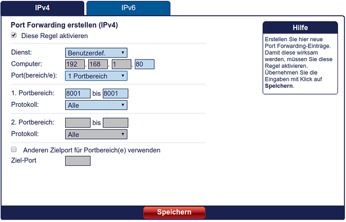

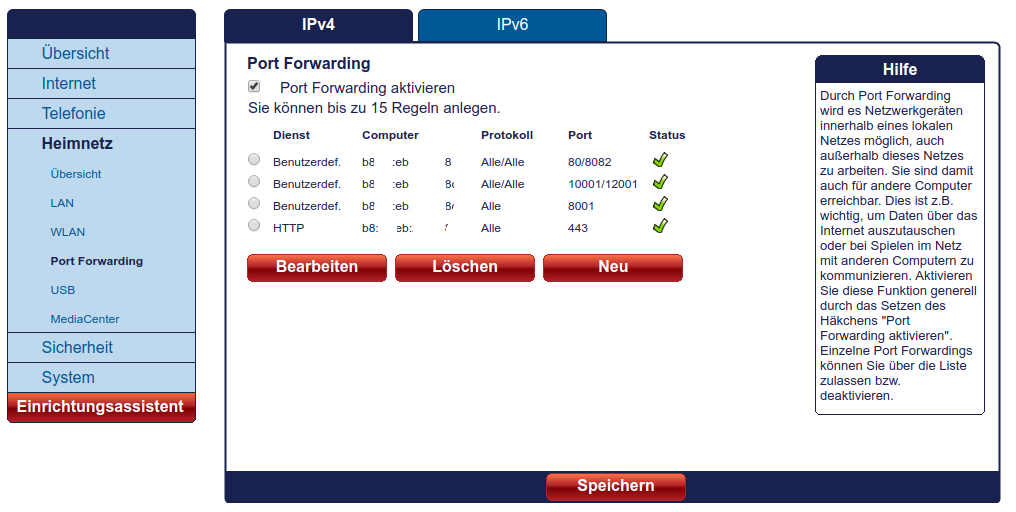

When I want to access seafile server over the webbrowser under my ddns-domain (Port 80) it stucks while loading the website:
When I access the server under the local address in my home network, it works fine! The Problem started suddenly, maybe after an system update. Before the server was running without any problems. After the problem occurs I performed a fresh installation (erase sd card content) on my raspberry but the problem still exists.
