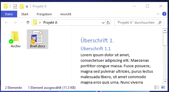

Hi Knert,
what you are talking about is file locking. File locking - by means of a little overlay icon - signals to other users that a file is being edited (see file brief.docx in screenshot below). A locked file can be opened by other users, but only in read-only mode.
As I said above: File locking is a standard feature of Seafile PE.
