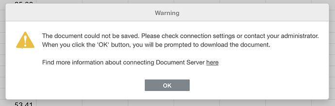

Hi, I installed Seafile Server Pro v6.2.1 using nginx, mysql, signed ssl (Certbot) and also installed OnlyOffice according to Seafile Manual “Deployment of DocumentServer via SUBFOLDER” using Docker-ce
I managed to get “Document Server Running” in https://myseafileserver.com/onlyofficeds/welcome/
but every time I open an office file I get the warning: “The document could not be saved…” as shown in the picture:

I didn’t find any solution to my problem in the forums, I don’t know what else can I do. Any help would be appreciated.
@DerDanilo @daniel.pan
Thanks!!!
Thanks/Frederic
