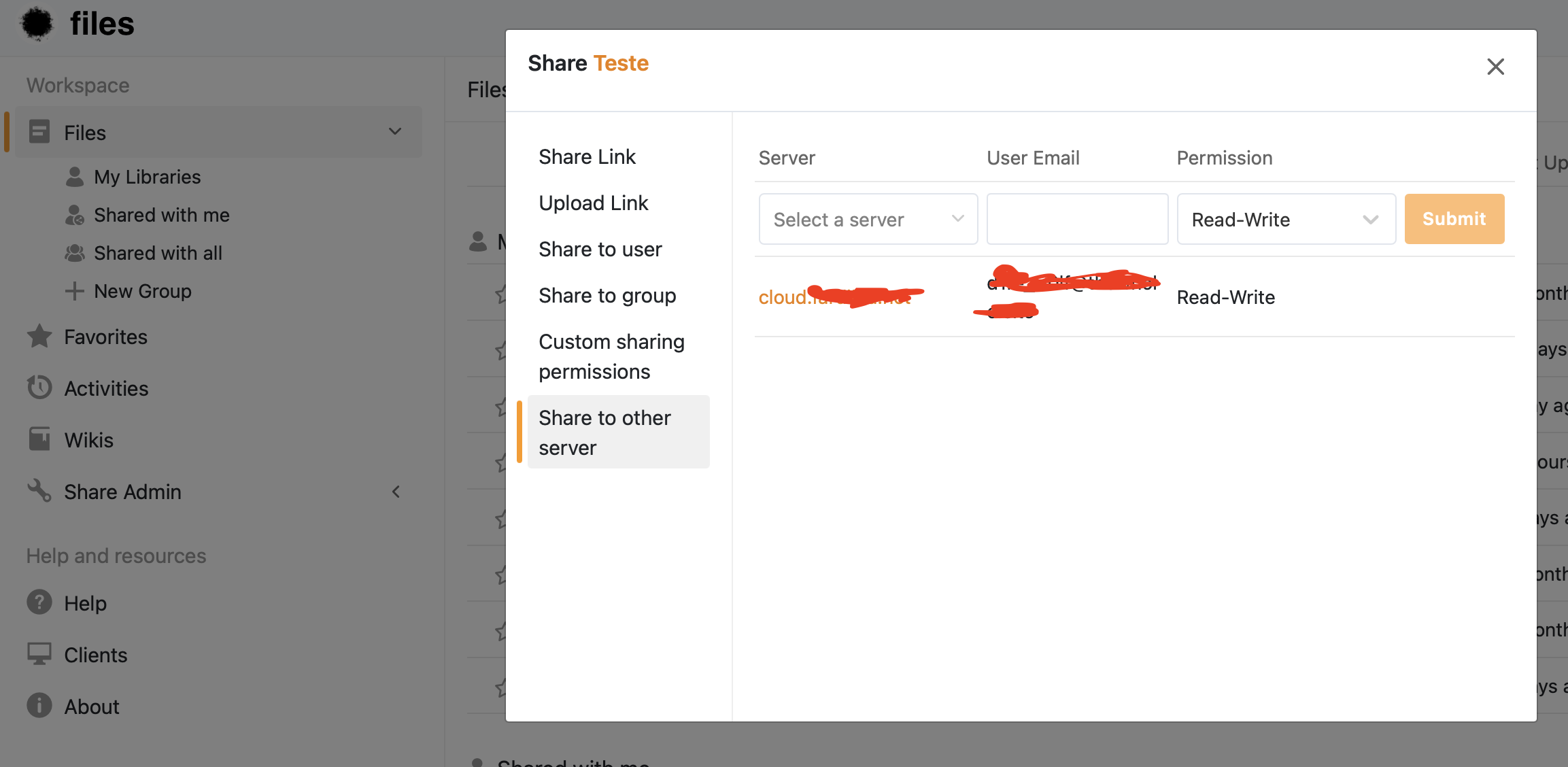

I’m trying to use OCM between two instances but there’s nothing on the files menu with the shared libraries.

Just a quick update.
Apparently I was looking at the wrong log, this is the error on the seahub log:
[2025-07-01 12:41:29] [ERROR] django.request:241 log_response Internal Server Error: /api/v2.1/ocm/shares-prepare/
