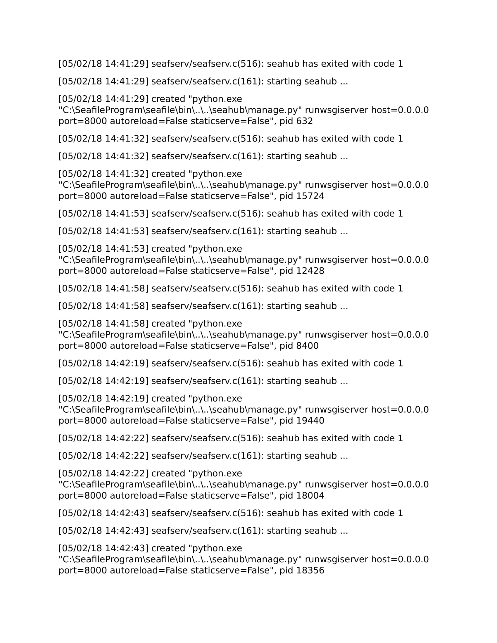

These are server logs I believe. I found them in Path: C:\seafile-server\logs
the restarts may be from when I clicked Restart Seafile Server option everytime I retested 127.0.0.1:8000 in the browser.
