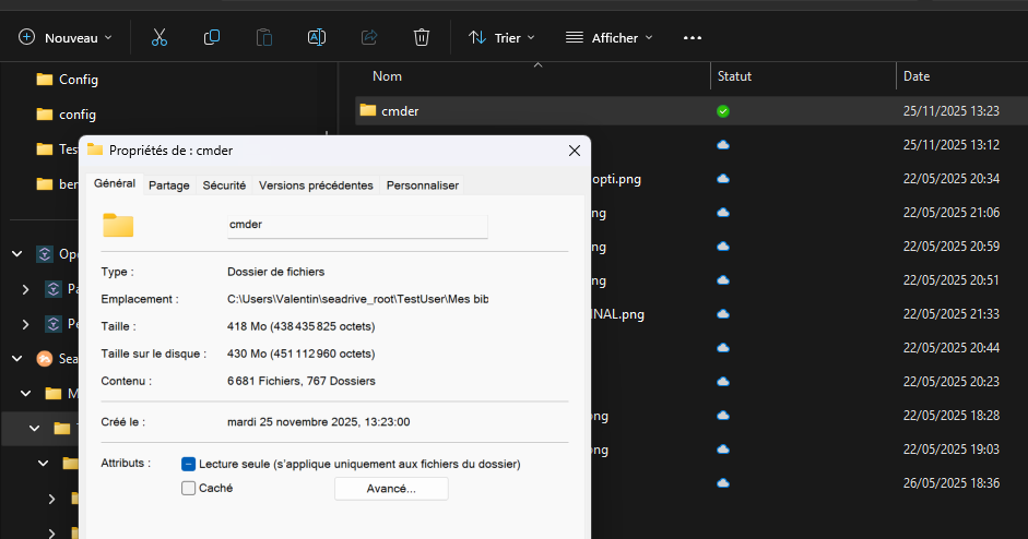

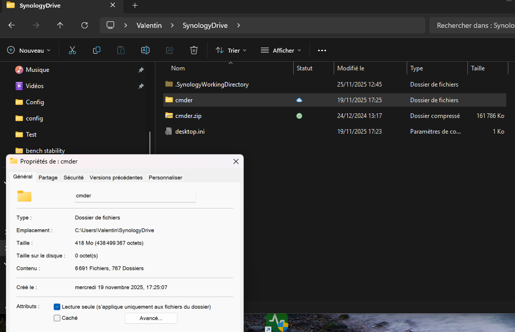

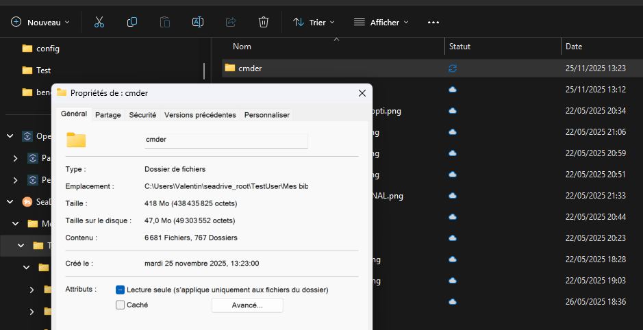

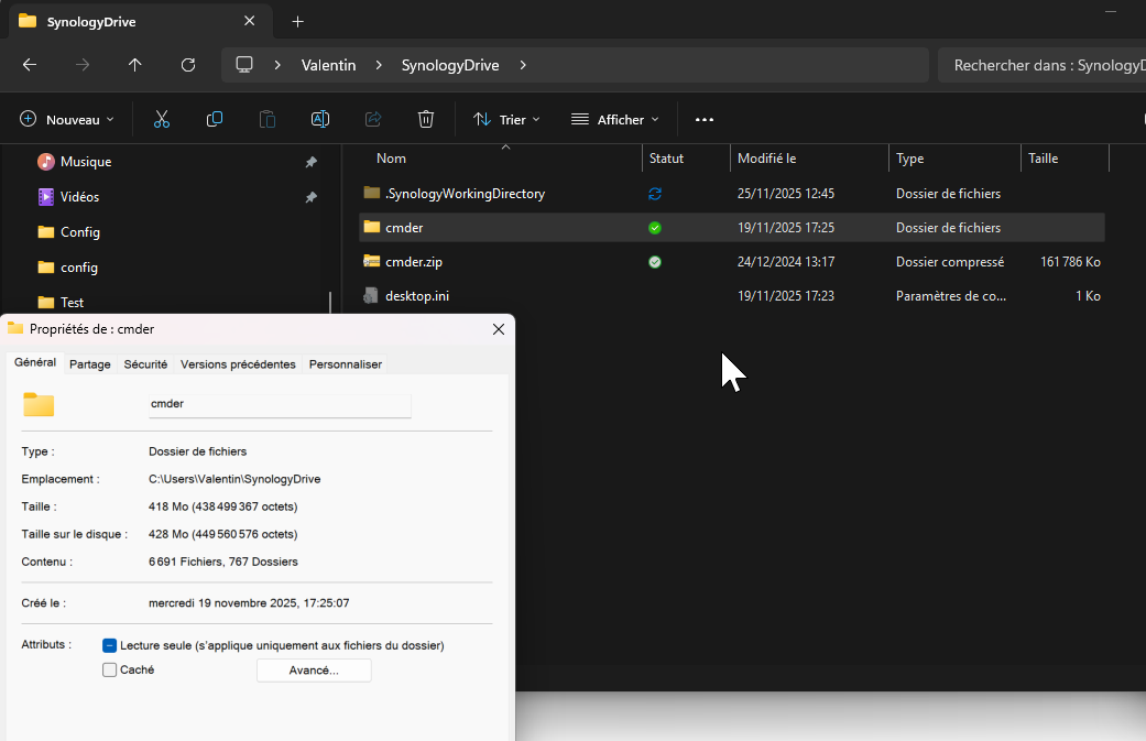

I am back to this issue because I recently retested it with the latest version of Seadrive 3.0.17 and Synology Drive Client 4.0.0, and Seadrive still has problems freeing up space, while Synology Drive manages to do so perfectly, which leads me to believe that the problem is not related to system modification events (especially since there are not many files in the folders concerned) but rather to a small adjustment that needs to be made in Seadrive.
Here are the screenshots:
Synology drive Pin
Synology drive Unpin (no problem)
Seadrive Pin
Seadrive Unpin (problem 91.2Mo not deleted and sync icon bug)
Seadrive pin and Unpin number 2 (problem 47Mo not deleted and sync icon bug)
No change after waiting for an hour.

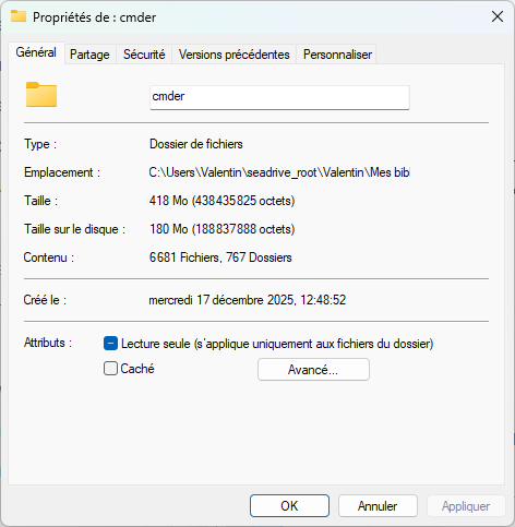

@feiniks I tried 3.0.19, which seems to contain the fix, but I don’t understand how you manage to get it to work on your system with the directory in question. Here is the result after freeing up space (and several attempts):
cmder.zip
