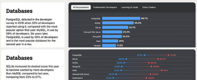

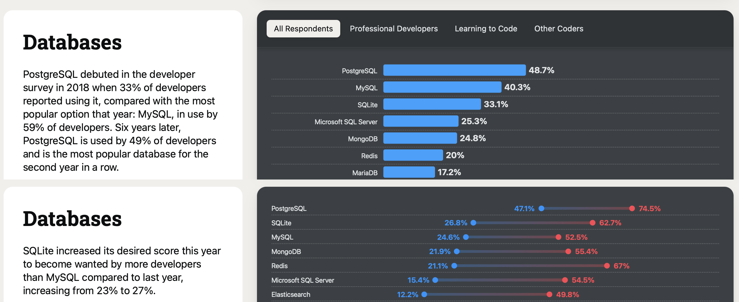

9 years later, can we move to PostgreSQL since no more evidence is needed towards the undisputed superiority of PostgreSQL to MySQL? :slight_smile:
At least we have SQLite.
For some reason I’m not allowed to include links, but just google stack overflow 2024 survey for the source.
