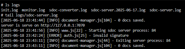

Logs in SeaDoc:
So the final error looks like “Permission denied”, this creating a new pages of a wiki
“{“error_msg”:“You don’t have permission to access.”}” and Error 403 Forbidden on the call too
