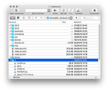

Since you’re asking, I assume you have not added WebDAV to your server yet. It has to be installed in CE and is described here in the Manual. The exact hookup will depend on the server itself as described in the Manual.
A good general purpose WebDAV client for Mac and Windows is CyberDuck. It is shareware but offers an extended trial period if needed.
