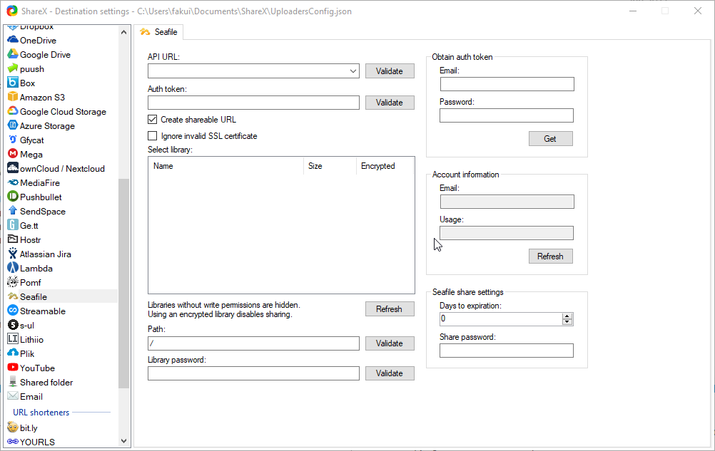

Just save the screnshot inside a synced folder and youâre done⌠If you want a screenshotapp which can be used with seafile, use ShareX - there is a plugin for seafile. You just need to configure it with login credentials and the target library. After that you can set this upload target as default. If you take a screenshot, it will be uploaded into seafile.
it seems I was very not very precise in my original post:
so having said this, it seems sharex does what I want and much more. I will see how it works, thanks for posting about it.
For Windows you can just change The place where windows saves the screen shots to your seafile folder.

I use ShareX, it allows you to save the screenshot to a specific directory or to upload it to seafile using the API and then copying a share link to the clipboard

Nice tool! I would have a look on it if it was a software for MacOS, too
Do you know further similar software that uses the Seafile API?
