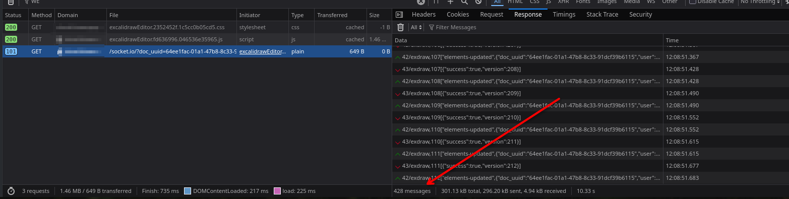

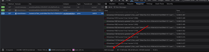

Whenever it exceeds some kind of threshold, it starts. As the server keeps the changes I suppose something might be wrong with clearing the queue after the changes have been send. As seen in the screenshot, the server answers with success, but the issue still persists
