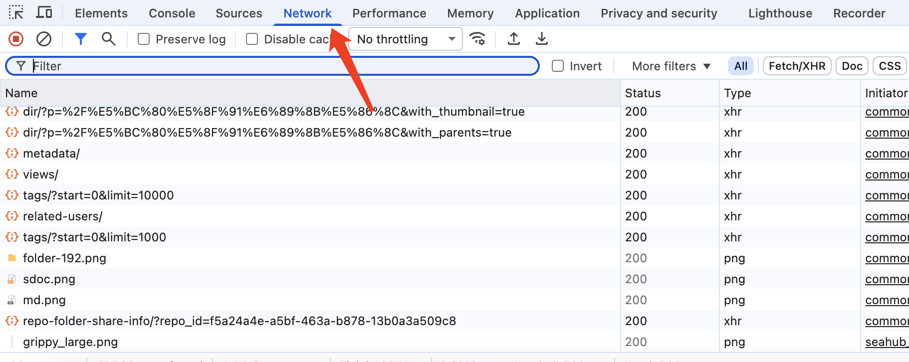

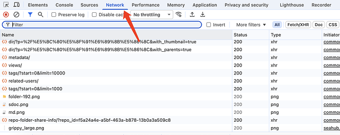

Can you try open the browser’s development console, then find the red color error request? Then click the request, you can find the detailed error message.

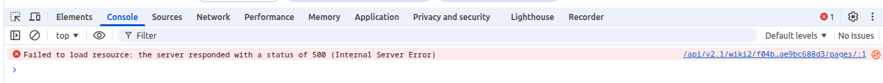

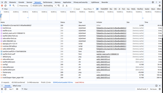

dbet1
December 1, 2025, 7:20pm
7
I’m sorry, but I’m not seeing any errors under Network, only the Console shows error 500. Perhaps I’m using it incorrectly; I’m definitely not a web developer.
