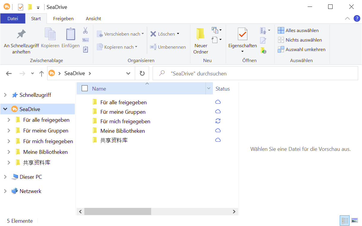

This is what the navigation bar in my Windows Explorer looks like:

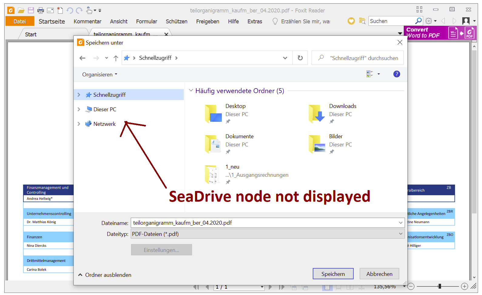

In Foxit PDF Reader, though, when I wish to save a file, the SeaDrive node is not shown in the navigation (see below)
On another computer, the same problem can be observed in MS Word (see below)

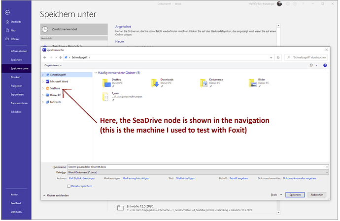

But the problem does not seem to be linked to particular apps. On my computer, though, I can see the SeaDrive node in MS Word.

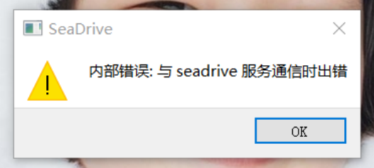

Hi! I have just updated a coworker’s Seadrive to 2.0.2, and now when I try to start it, we get following error:
(“Internal error: error communicating with seadrive service”)
I uninstalled seadrive, removed both seadrive folders in user’s profile, reinstalled, logged in, and as soon as it starts to download the files list, this error appears. Seafile in browser works fine. Any ideas where to look?

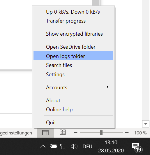

Can you share your seadrive.log and seadrive-gui.log? Also have a look at logs/dump folder for any crash dumps.

Do you still have 1.0.x client running? Or have you tried to restart the computer? Looks like some other process is opening the same named pipe, so the new seadrive client cannot access it.
Hi!
In the end my colleague was able to resolve the problem by:
  1. Uninstall Seadrive
  2. Delete all Seadrive files in user’s home directory
  3. Delete all Seadrive keys in the Windows registry
  4. Install Seadrive again
Happily syncing again! :wink:

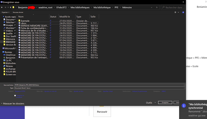

/20 10:07:45] All events are processed for repo c315c276-3604-4603-b699-e2b2dfcad309.
[05/28/20 10:07:45] Repo 'Perso' sync state transition from 'committing' to 'synchronized'.
[05/28/20 10:08:14] [obj backend] Failed to rename C:/Users/Utilisateur/seadrive/data\storage\fs/c315c276-3604-4603-b699-e2b2dfcad309/8a/70b43f85d35f85fb9579e7c3ca457513b667cc: Permission denied.
[05/28/20 10:08:14] [obj backend] Failed to write obj c315c276-3604-4603-b699-e2b2dfcad309:8a70b43f85d35f85fb9579e7c3ca457513b667cc.
[05/28/20 10:08:14] Failed to write fs object 8a70b43f85d35f85fb9579e7c3ca457513b667cc in repo c315c276.
[05/28/20 10:08:14] Failed to get file object 8a70b43f85d35f85fb9579e7c3ca457513b667cc from server https://seafile.abc.com.
[05/28/20 10:08:14] CfHydratePlaceholder failed on C:\Users\Utilisateur\seadrive_root\a6682be4\My Libraries/PA1\R2017b/create_acct_email_ver.png: **The cloud operation was unsuccessful.**
I had messages like this “The cloud operation was unsuccessful”.
Seadrive should try to resynchronize the files that have had this error.
It’s very tedious to have to search for unsynchronized files in a tree structure and do it manually
Small precision, the Parent folder is configured in “Always keep on this device”
Hi @hydrandt
Can you check seadrive.log?
