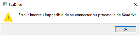

I installed seadrive 2.05 on win 10 PC with Avast free edition.
At system boot, an error message telling its’ impossioble to find seadrive process
Launching the programm leads to this message
seadrive.exe is dropped due to suspect IDP.Generic

Even after uninstalling Avast (I also have Kaspersky) and Seadrive and reinstalling Seadrive, i still have this error
I managed to log in with shiiboleth but the process did not end.
Now i have an error login to the server

[08/25/20 09:16:49] Unable to switch to account https://seafile.domaine.fr u@domaine.fr 9bac4a1 : unable to decode byte 0xff
[08/25/20 09:16:49] Failed to connect to named pipe:
[08/25/20 09:16:50] Failed to connect to named pipe:
[08/25/20 09:16:51] Failed to connect to named pipe:
[08/25/20 09:16:52] Failed to connect to named pipe:
[08/25/20 09:16:52] Exiting with error: Erreur interne : impossible de se connecter au processus de Seadrive
[08/25/20 09:16:52] Seadrive daemon process exited normally with code -529697949

@Jonathan @rdb is there any way to remove the account ? Reinstalling Seadrive does not help
I finally uninstalled seadrive, dropped user acccount and reinstalled seadrive,
It works well with Kaspersky

The error message means seadrive.exe doesn’t start normally.
With SeaDrive 2.0, at least the anti-virus software won’t download many files from the server. But as the file names exists in local file system, anti-virus software will still scan them. So is for Windows search indexing.
On another computer, i managed to make an exception on Avast for seadrive.exe
@Jonathan It also occured. I had to start it manually
next automatic start is ok
