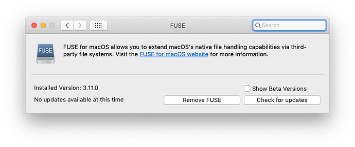

Looks like you have not installed the kernel extension for Fuse. Do you have a control panel in System Preferences?
Do you have administrative access to this computer? Any security settings that might prevent software installation?
Hello Mercury,
Yes, i was connect with the local administrator account and I had the same thing you had for Fuse.
No security settings. We have a park of about 200 mac, and it is one of the only ones that are currently causing problems .
