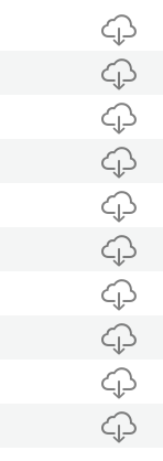

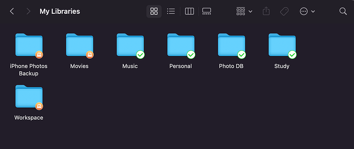

I just upgraded SeaDrive from the previous version 2.0.26, but seems like the overlay icons are not there.
Above is what I used to have, and what I was expecting.
I only have a cloud icon now. No blue cloud, no green check, etc.
To be fair, they were also not shown in the manual, either (look up Seafile drive manual for Mac, can’t post links here :frowning: )
My Finder has no green check marks and/or any other icons visible. When I download a file via the “cloud icon”, it simply shows a normal file with no icons whatsoever.

This is the normal behavior of macOS’ File Provider API. If you OneDrive, iCloud Drive, they all are the same.
The status of files/folders are actually there, but they’re just not the same as 2.0 version.
